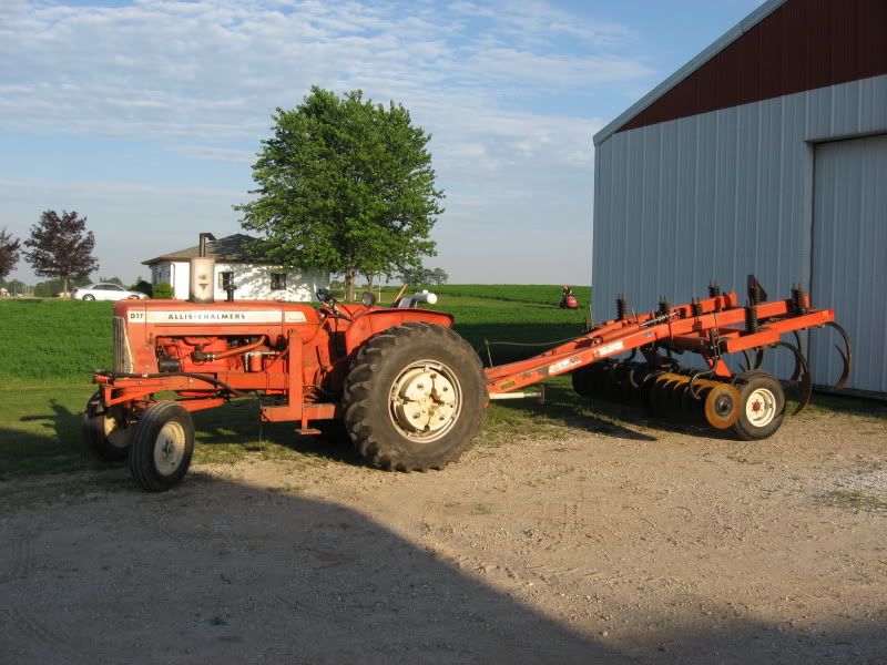

Would you believe this picture?
In all seriousness I pulled a 5-shank gencoe with a 6080 fwa and like Jordan now pull this AC 7-shank with a 8030fwa and hover between 5th and 6th (power shift) gear depending on if I am driving up a grade or down.  Our soil is on the heavy side and some of my fields have a roughly 20' elevation change on a 6 acre field.  I agree that when you put the AC next to the glencoe it is built so much heavier and with greater trash clearance.  It sure is a nice machine.
Mike
That's a cool pic Michael. Reminded me of back when I was farming. Our place was on a busy state road and one year when we happened to be ahead of the game so each day for a solid week after work in the evenings I worked corn ground out by the road with the 190XT and 16' HD IHC disk  And just to fool with the neigborhood nib-chitters I would unhook the disk in the field, but out by the road and after dark. Then drive the XT to the house. We had about 10 sets of rear Farmall weights so I put them all on Dad's Farmall H. Drove it to the disk each evening hooked the disk pulled it far enough (first gearLOL) to cover the tracks and left it parked out where everyone driving by all day could see it, had a lot of fun with that. Wish I had dreamed it up on my own. Idea came from a neighbor who regularly would pull 2 empty 350 Kilbros gravity beds w/tiptops to the field with his 10HP Cub Cadet, Fill them to the top with corn and leave it there long enough for 100s to drive by and see  the rig and pitch a bi,,, about dumb S..,,, trying to pull 2 big wagons with his garden tractor. Guess we had too much fun farming and screwing with nosy people, LOL

Butch,  I can not imagine you stirring the pot like that.
