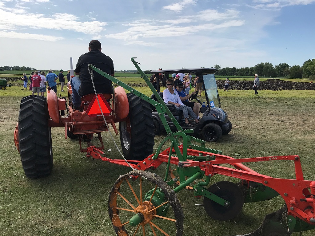

This is my WD with new 14.9-28 on 13" rims this past summer. I can't put them all the way in without hitting fender, personally I think they're just right and wouldn't go bigger.

That is a nice looking set of tires on your 45!
