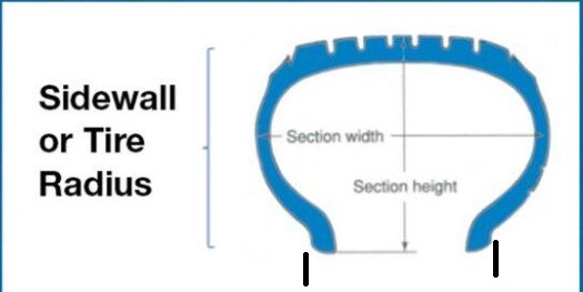

Tires that get put on rims that are wider, tend to have the tire sidewalls too straight. Which can affect the way the tire tread grips the soil, and adversely affect tire wear, plus straight side walls may give a ‘firmer’ ride.
