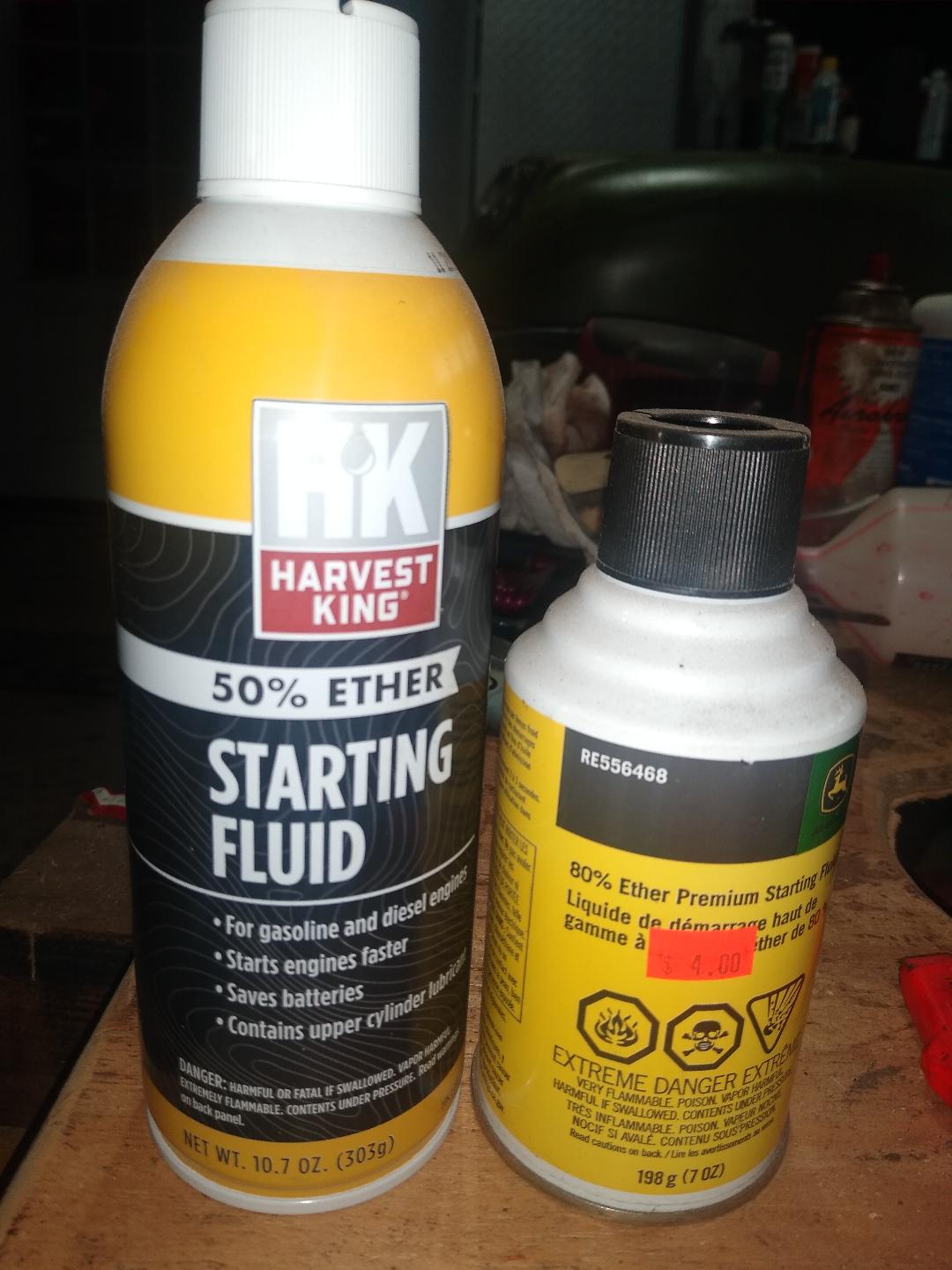

Post Options Post Options   Thanks (0) Thanks(0)   Quote WF owner Quote  Post ReplyReply Direct Link To This Post Posted: 20 Jan 2023 at 7:46pm
Here's a photo of the two kinds of starting fluid I had on hand.
