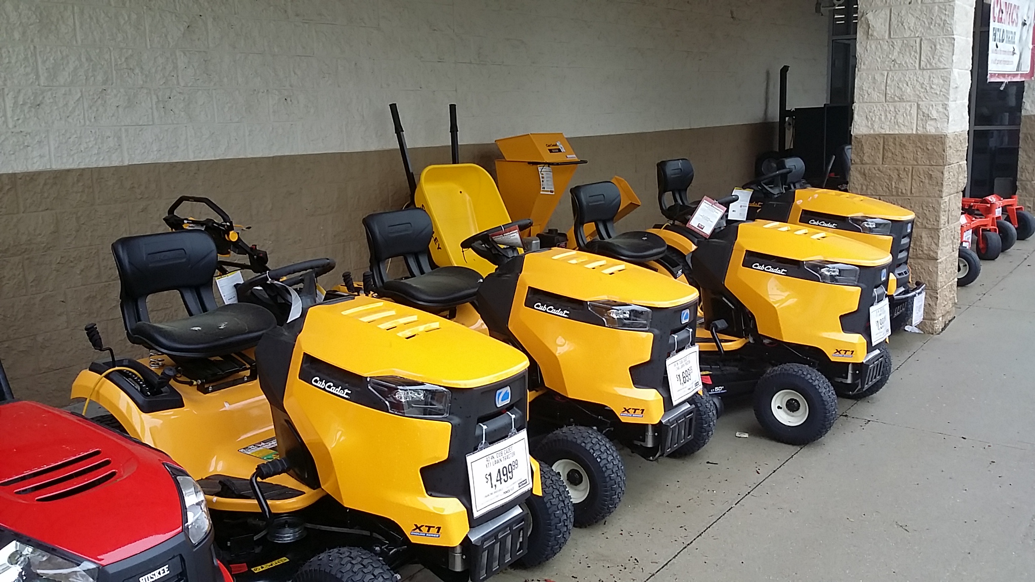

This one in my opinion was a very close match. Looked really good on the mowers at TSC. Might want to take a look or run by a store with a part from a covered area on your B1.

That looks like a good color
