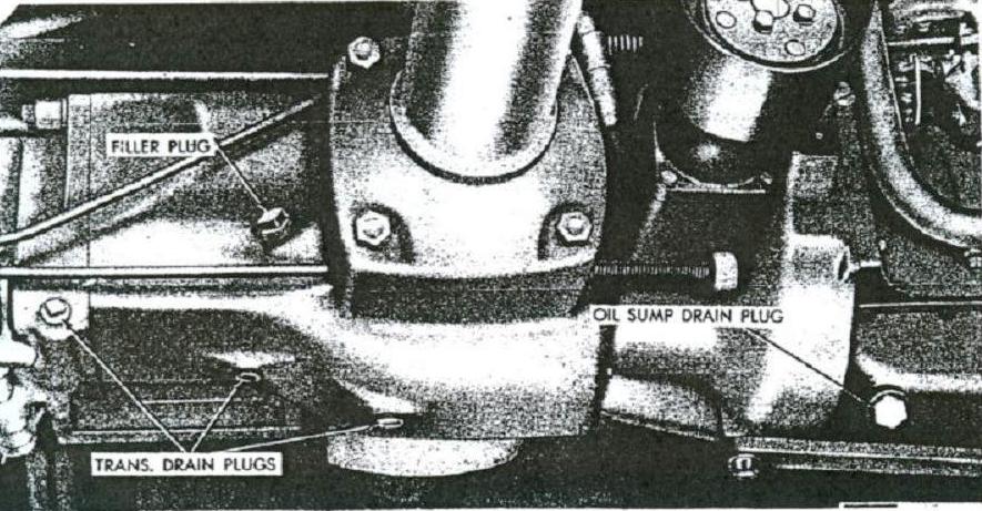

Manual says SAE 20W. I've been using good quality hydraulic oil in both of my G's for years without problems. Don't forget to drain both holes on the tranny/hyd. housing.
