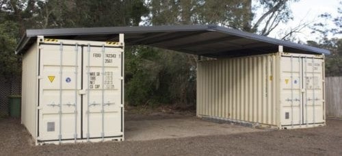

Post Options Post Options   Thanks (0) Thanks(0)   Quote jaybmiller Quote  Post ReplyReply Direct Link To This Post Posted: 03 Mar 2019 at 6:22am
not mine, found on google.....

Post Options Post Options   Thanks (0) Thanks(0)   Quote Scott B Quote  Post ReplyReply Direct Link To This Post Posted: 03 Mar 2019 at 9:16pm
That’s what I’m aiming for Jay. Except want more pitch on the roof and then another 8’ on each end
