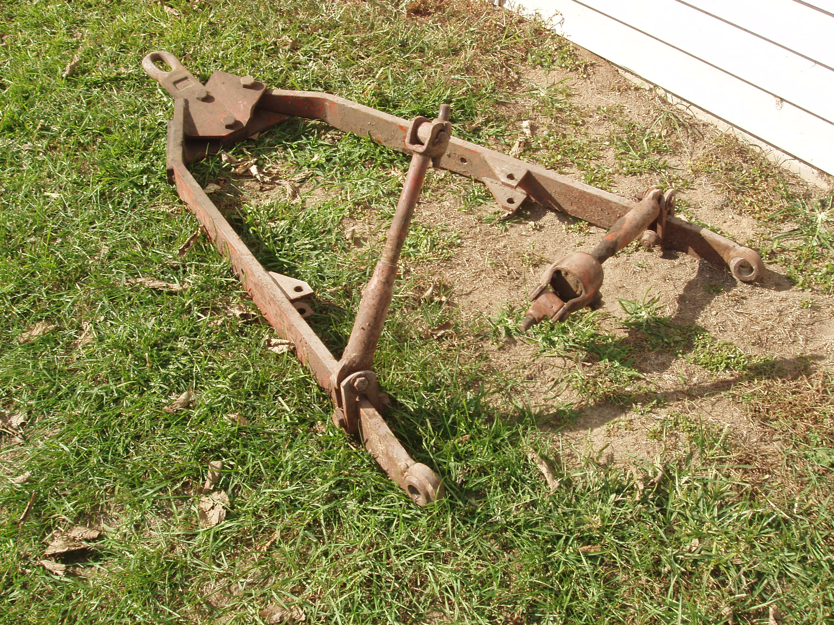

Bought this adapter at an auction, a couple weeks ago, and I'm wondering what I need to fit in the 2 brackets along each side. Can I make something to fit in there, or does anyone know where I might buy one. Planning on using on a WD-45. I also need the 3rd link bracket. Thanks in advance.  Fred.

Fred I will go look at mine in the daylight. I have the same one I use on my d17.   I bought a top link mount from OK Tractors very rugged and we'll built. I would guess he has them for a wd as well. I can't remember if I have the part you are missing or not it was about 9 years ago I used mine. Now it sits off to the side in my barn.

Go to AC Plows parts 101 in the knowledge forum and download the plow frames book linked there. It has the hitch assemblies on separate pages from the 60 family plows. OR look at www.grandpastractor.com for the WD52 and WD53 Pickup plow manual.

The brackets on the side were for 3 point top link, not to be used with PTO equipment. The other type of top link bracket is made for use with PTO equipment. HTH Tracy

I have a factory top link bracket that is for the wd45 that I will sell. Send me a PM if interested.  Matt

I have one that looks like yours, it has two pipes (that fit one inside of the other) bolted in those brackets. Good Luck
