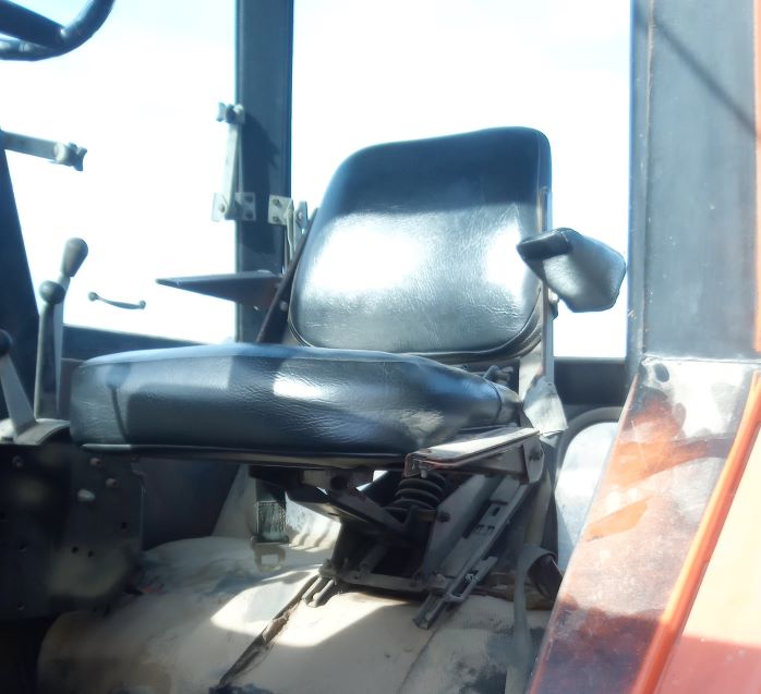

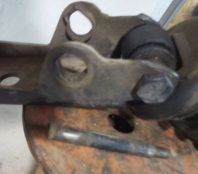

Finished doing some seat repair in the 7000. Suspension bushings were worn, pins were worn, and it was getting to the point of being painful to spend too much time in it.Started off last saturday taking it apart.
Found a few pieces that needed some weld added.

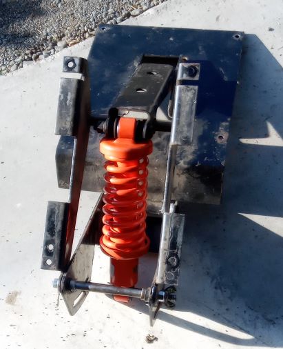

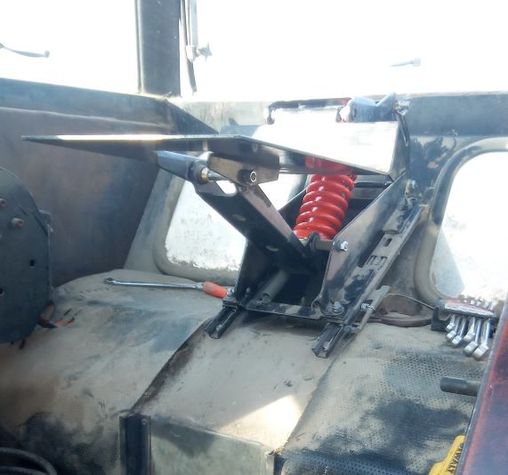

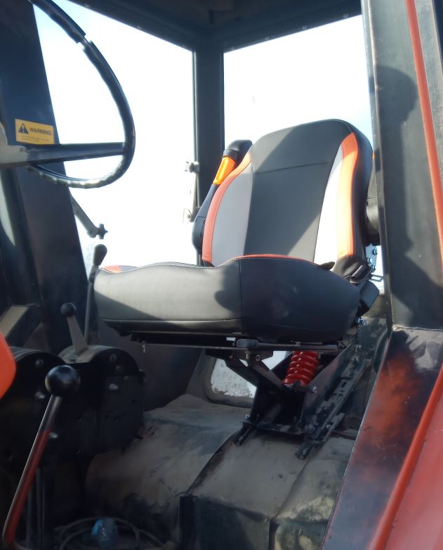

got things welded up and ground back down sunday, and got it all back together with new bushings and shock/spring assembly today. Put it back in the tractor and put on a replacement seat.
Luckily had my stepson to help with the project, he didn't want to get out of the seat after we got it done.

Looks good!

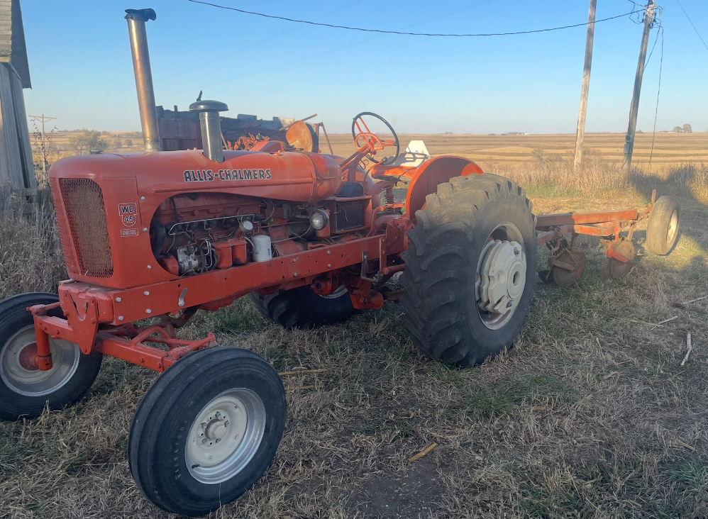

Had a little bit of fun today with my 45 repower diesel
Thought I give it a chance to see if it would pull that plow at all due to it being a 4-18.
And it did as long as you didn’t mind the front end being in the air!!
