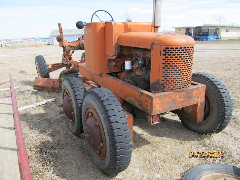

Lots of good pointers.  Here's the ad.  There are more pics, so thought best to let everyone look it over.  Thanks for all the comments.  I don't have experience with graders  beyond an old leaning wheel Adams towed behind a tractor.

From the photos it is the basic grader plus the leaning front wheels. It appears as if there has been some welding and reinforcing of the tube frame which is not uncommon. It looks as if the generator has been replaced with an alternator. If the steering gear box is good and the transmission and the crown and pinion gears are good then most everything else can be repaired if there are problems. They weigh about 9500 lbs. if you have to factor in some shipping. I would start off offering in the $3000 range since it is over 50 years old and some parts for the drive train may be impossible to find. I have done a lot of modifications to mine to make it more user friendly such as adding power steering, foot controlled throttle and shifting the moldboard controls so that I can use one hand to control the moldboard and steer with the other hand.
