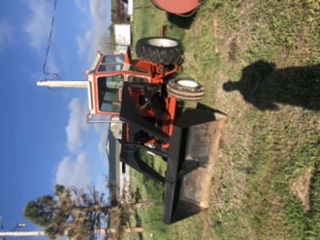

Welcome to the forum!  I'm about 20 miles or less south of you, west of Niwot.  You are quite close to Francis Banderet, who used to be the AC dealer in Commence City, now has Flatiron Equipment, 8127 W I 25 frontage road a bit north of highway 52.  He has several AC's around his place, used to have some at 287 and the road into Berthoud.
I wonder if you can reach the flywheel easily and try moving it with a big screwdriver, just to make sure the engine isn't locked up.

I don't think you have air conditioning. Is there a compressor under the hood?
Points: 8987
Post Options Post Options   Thanks (0) Thanks(0)   Quote SteveM C/IL Quote  Post ReplyReply Direct Link To This Post Posted: 12 Apr 2020 at 9:58am
One way or another I would want to be certain the engine was free before I tried to make it run.

Thanks for the info sounds like there could be some good resources close by! I had that thought also. I will be pulling the starter to see if I can turn it by the flywheel probably this weekend. It’s been a little too cold the past couple days

So I finally got some time to mess around with the tractor. I pulled the plugs last week and noticed some rust on the ends of a couple plugs so I suspected the engine was seized. I sprayed some penetrating oil in the cylinders and let it sit for a couple days. Then sprayed some more and then some more. I hooked up a battery and after bumping the starter a few times it broke loose! So we sprayed some carb clean in the intake and it will fire! So good news is the tractor should run. I ordered a rebuild kit for the carb and I’ll be changing the oil and plugs soon. What oil and plugs are the best to use?

Wow! Awesome that it is going to run for you! Thanks for the updates. More pictures needed too.

Man that's a nice tractor. Hope it's running soon.
