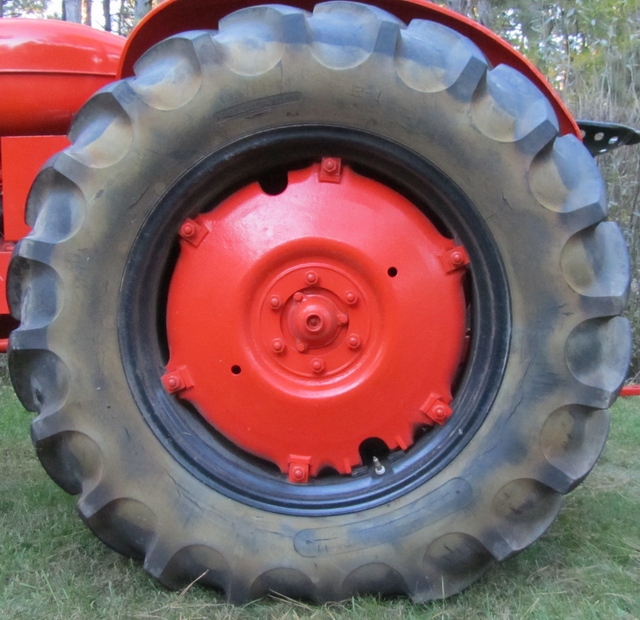

Were the WF rear wheel centers all different than the WC or is this difference just because my WC is a 1944 and the WF is a 1950.  The casting numbers have a different dash number.  The WC casting number is AM-3082-8 and the WF is AM-3082-18 (could be -10 I couldn't see it very well).
The difference is easy to see, the gap between the rim and the hub between the wedges is much wider on the WF.  One can easily slide their fingers through but on the WC there is very little gap.  Also the dimples on either side of the valve stem are quite large.  Does someone have a late WC with centers like the WF or an earlier WF with centers like the WC?
WF:
WC:
Thanks
Tom

I have a 49 WF and 47 WC, the rims are the same as yours.

So it looks like no WC's ever had the rear center like my WF, but it may just be an updated center after the WC was no longer being made.  The parts book I have is for WC and WF and it doesn't show any different centers for the cast hub like this.

I looked at my 49 WF, has same centers as yours, never looked that close before, just a thought, maybe when the WC ended they changed because they didn't need near as many and maybe an outside supplier.

My WF has the cast hubs as your pic.  There are 5 WF's at the local wrecking yard and they all have the same cast hubs except for one which has 24" one piece steel rims. I always thought they were combine wheels. ???

My 47 WC has wheels like the top picture and my 39 WC has wheels like the lower picture.
