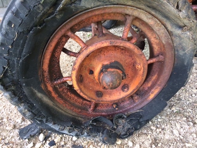

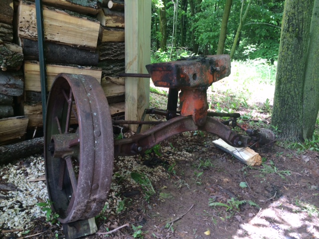

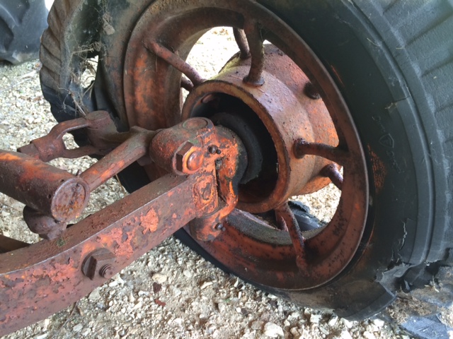

I am currently working on restoring my 1938 WF and my first step is to get the old girl back on the steel wheels it would have originally had coming from the factory. It currently has cutoff steel all he way around. I have a set of rear steel taken care of (could use some lugs thou) so now I'm ready to tackle the fronts. As most of you know finding a good set of front steel for a WF is pretty much out of the question.......so I'm left to try and rebuild the ones I have and bring them back to steel from cutoffs. What are my options here?? Does anybody do this yet? Detwilers??? Does anybody have experience doing this themselves and if so how did you go about doing this? I have a decent amount of metal fabrication and machining knowledge and have access to a complete machine shop, laser, press brake, etc. I would greatly appreciate any help or ideas you guys can provide.
I will upload some photos a bit later.

Can you post some pics of what you have?

I Don't believe that WC steel outer rims will match up. The WF Spokes are a little thicker, and are at a different angle from the cast hub to the outside rim. I have been searching for another wheel that F & H made that matched the spoke configuration of the WF front steel. So far, I have not found anything close. I still have faith that there is a pair out there somewhere.
