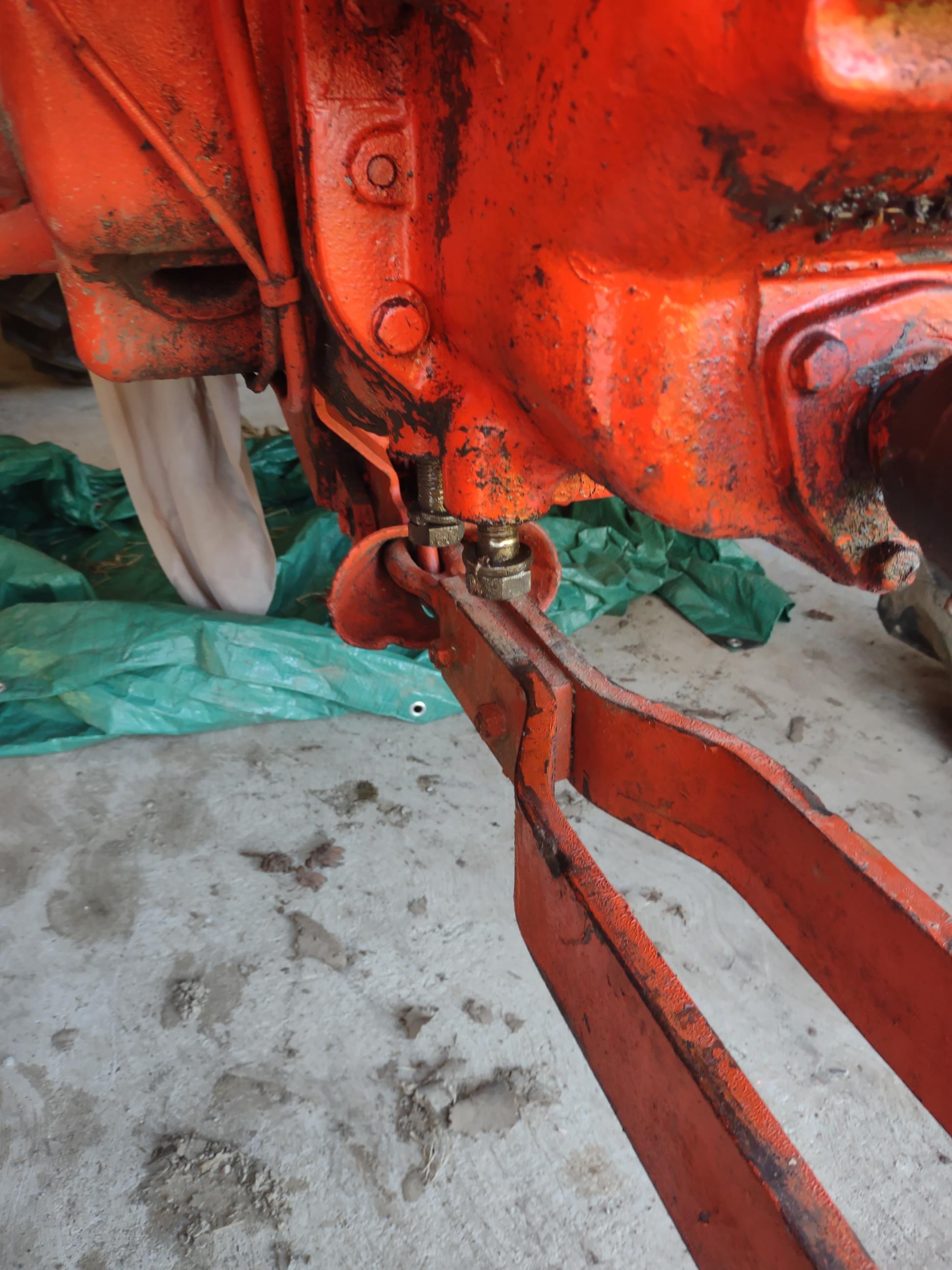

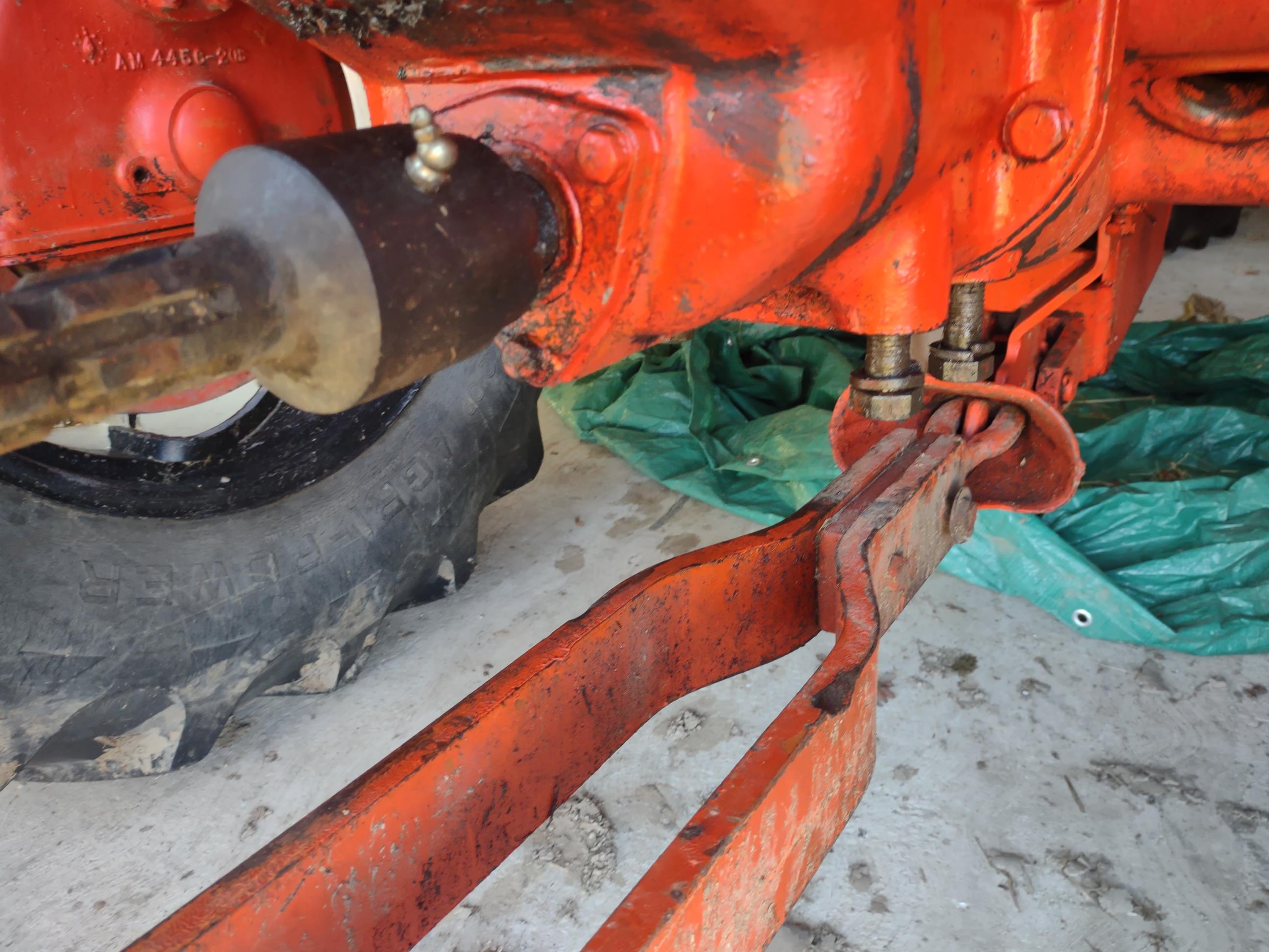

were do i hook up my 80 sickle bar mower?

this is not like the old d17 I had

r ... the thing hooked up in pic is my sc blade i have the piece that hooks to tractor just dosent look like my old d17 under there

look in the parts book. Shows the brackets needed. Hangs off the pins where the draw bar hangs. And the balance spring, has like a C bracket that bolts around bottom of axle.

well the pictures shown is missing the brackets

yea my drawbar/3pt set up is diff than theone i had before no were to hang the piece to hook mower too

Your tractor is missing the drawbar brackets where the mower bracket mounts.              MACK

The brackets that you are missing are tractor related, not mower related (even though your mower bracket does attach to them). So I would head to a salvage yard to find them. The draw bar bail attaches to the missing brackets as well. Darrel
