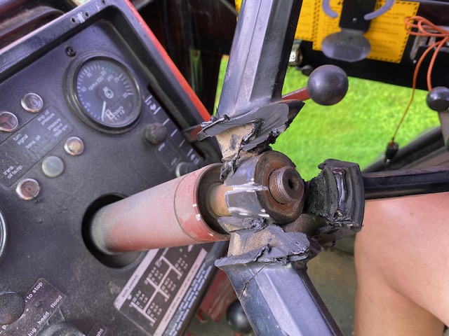

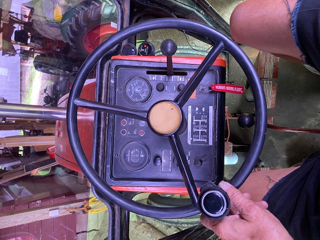

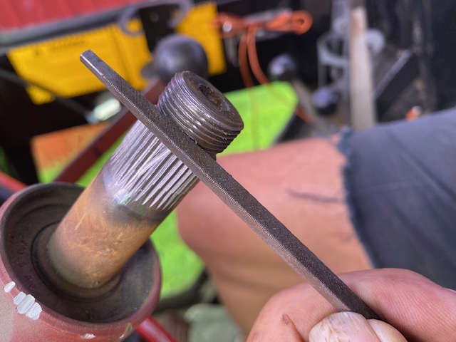

Hot this morn, box fan in rear window blowing outward. Installed new smaller wheel in 7000. Tried heating nut with torch…don’t even think about that. The plastic burns and fills cab instantly with TOXIC fumes. Just 4” grind both sides. Other than that mistake all went ok, and love the difference !
