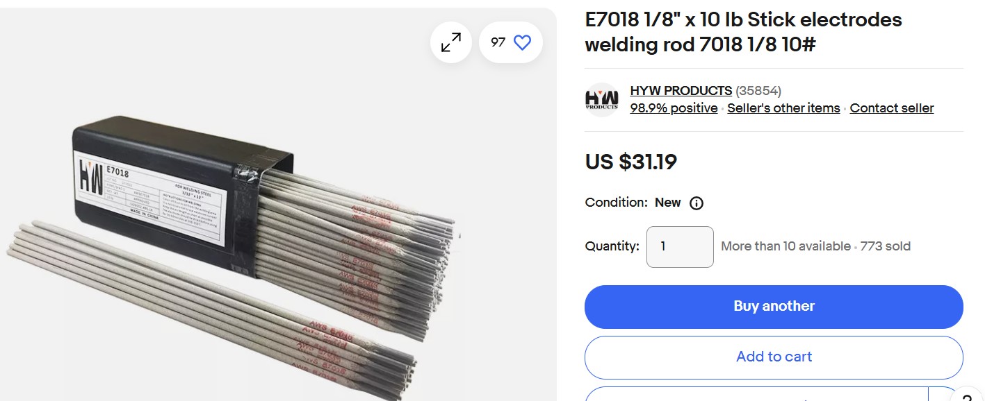

I buy 10 pounds of welding rod every 3-4 months.. Tend to buy the HYW Brand on e-bay... Cheap and works good (7018) ... I keep it dry in a box with a small light bulb inside... Not a rod oven, but keeps the humidity way down...
New project needed 1/8 rod this month....

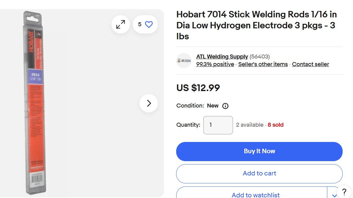

If you really want to weld on 120v with a stick welder.... i might be temped to try something like this...OR MAYBE the 5/64 rod in the NEXT POST...
the 1/16 might be BETTER if your welding 19 gauge body panels !!
Edited by steve(ill) - 27 Dec 2024 at 5:00pm

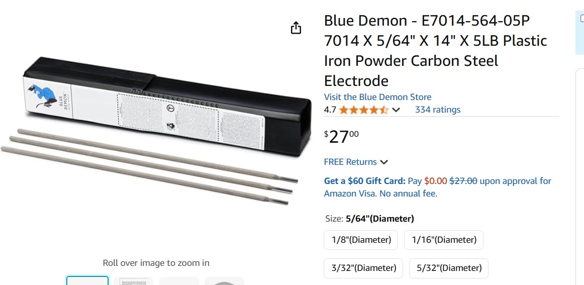

Post Options Post Options   Thanks (0) Thanks(0)   Quote steve(ill) Quote  Post ReplyReply Direct Link To This Post Posted: 27 Dec 2024 at 4:51pm
the rods between 1/16 adn 3/32 are called 5/64 inch dia.... this might be an option.... 7014 dont have much of a tendency to STICK like some other rods.

Post Options Post Options   Thanks (0) Thanks(0)   Quote desertjoe Quote  Post ReplyReply Direct Link To This Post Posted: 27 Dec 2024 at 5:54pm
Well,,I'll be danged,,,"Blue Demon",,,!! The local welding supply used to carry the Blue Demon rod years ago and I had very good results using it,,but of a sudden,,,they stopped carrying it and just told the customers they could no longer get any,,,,??
 Whatever I decide,,,I'll have to order some in small pkgs for trial if better than the HF el  Cheapo rod,,,

Post Options Post Options   Thanks (0) Thanks(0)   Quote steve(ill) Quote  Post ReplyReply Direct Link To This Post Posted: 27 Dec 2024 at 6:24pm
yea, i got a little carried away with Information... IF what you want to do is weld SHEETMETAL with a STICK WELDER... i would think the 7014 in a 1/16 rod set about 40 amps would be a good bet ... If your doing GENERAL WELDING with the INVERTER welder and want to use 120v... I think the 7014  - 5/64 set at 60 amps would be a good bet.. as long as the metal is about 1/8 inch or thicker.
