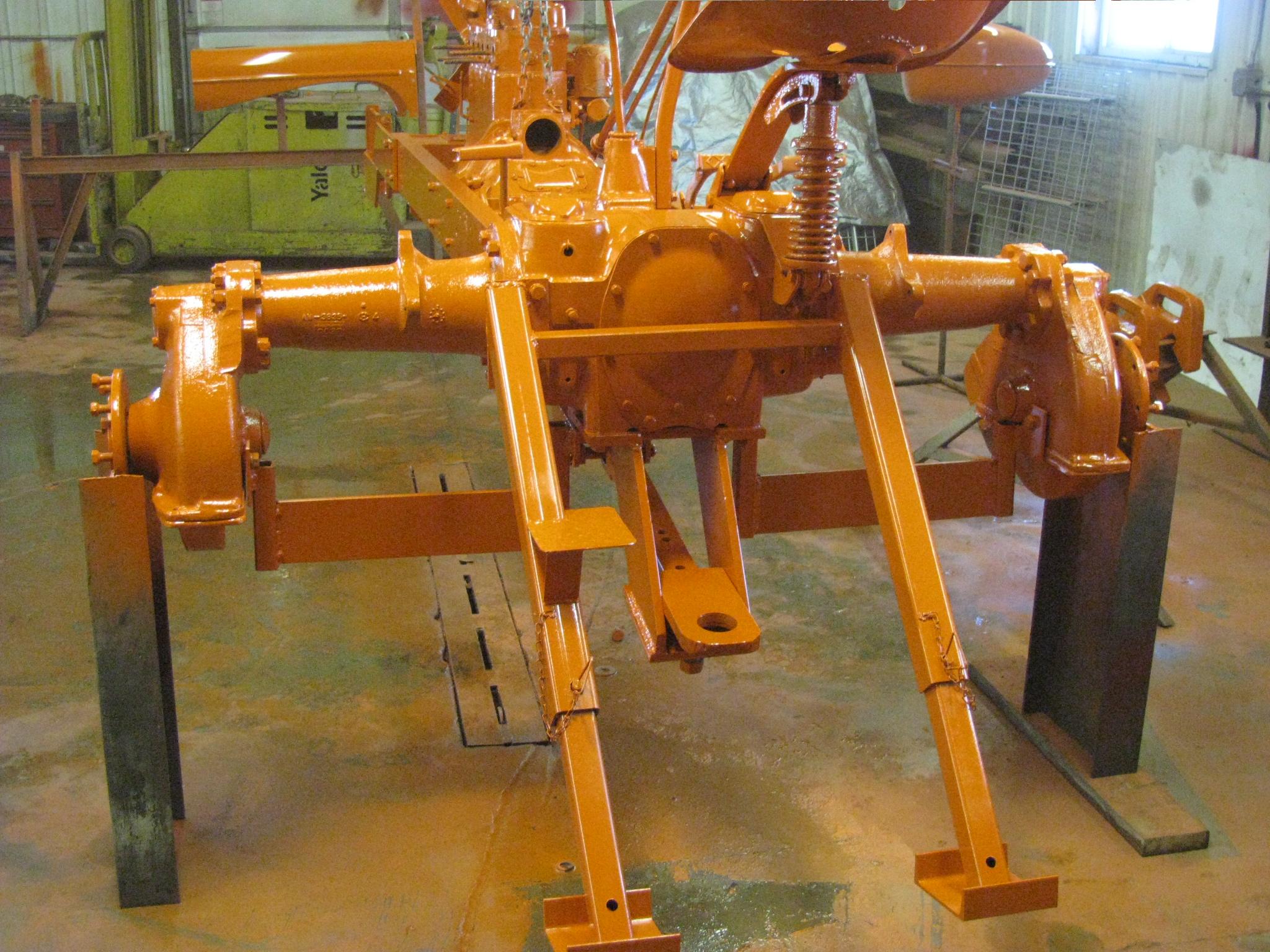

Post Options Post Options   Thanks (0) Thanks(0)   Quote Fields Quote  Post ReplyReply Direct Link To This Post Posted: 10 Jan 2013 at 8:40pm
rear view the final drives are  taped for corn picker mounts so use them holes. the center is bolted to the  factory holes and the draw bar is a non snap coupler front half .

Post Options Post Options   Thanks (0) Thanks(0)   Quote cotncrzy Quote  Post ReplyReply Direct Link To This Post Posted: 11 Jan 2013 at 6:36am
What thickness of material is the front bracket made of?

Post Options Post Options   Thanks (0) Thanks(0)   Quote Fields Quote  Post ReplyReply Direct Link To This Post Posted: 16 Jan 2013 at 3:38pm
I'll try to measure it tonight. Last I know Phile had a steel one Just like this for sale. He made a Aluminum one fro himself.

Post Options Post Options   Thanks (0) Thanks(0)   Quote Fields Quote  Post ReplyReply Direct Link To This Post Posted: 19 Jan 2013 at 10:21am
The main beam is 1/2 "  you could build it lighter. mine is 150 to 200 pounds I'd have to weight it.

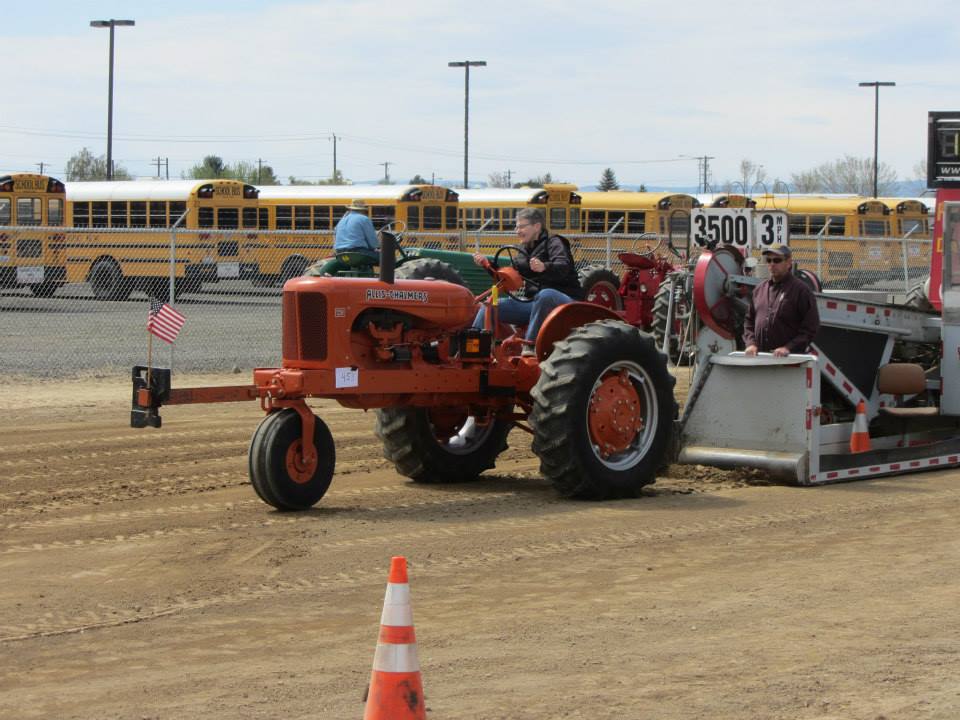

Post Options Post Options   Thanks (0) Thanks(0)   Quote Fields Quote  Post ReplyReply Direct Link To This Post Posted: 10 Feb 2013 at 3:23pm
Well it was 3800 with me on it when I first built it. The front end was the heavy wd45 one. I changed it to a early wc one. From what I have learned there are 3 differnt weight narrows. The early wc are 120# the mid to wd  ones are 180# and the wd45 ones are 320# a wide front is 350# . Phile built a Aluminum one like the one he build for me. I think he said it was like 100# lighter than the steel one. I think with the 13.6-38 wheels on back and no front weight braket  it would be 3200# bare.

Post Options Post Options   Thanks (0) Thanks(0)   Quote cotncrzy Quote  Post ReplyReply Direct Link To This Post Posted: 11 Feb 2013 at 5:40am
My tractor weighed 3300 pounds before the new weight bracket. Now we looking at 3365. I still have the hand clutch, my eight year old uses it. My oldest son pulls it in the 3500# class, now with him on it we will weigh in at 3545. I may have to go to aluminum front wheels to keep him in the 3500.

Post Options Post Options   Thanks (0) Thanks(0)   Quote EricSWPA Quote  Post ReplyReply Direct Link To This Post Posted: 13 Feb 2013 at 9:42pm
My WC made 3000 lb when I weighed 200lbs with 13.6 38 tires on the back but it was close lol my buddy that does a lot of my welding suggested aluminum frame rail. But it made it might be a idea for a WD though]

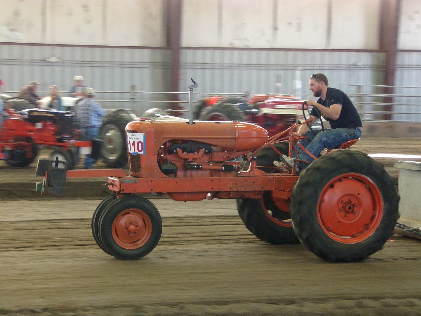

Post Options Post Options   Thanks (0) Thanks(0)   Quote Brians1946 Quote  Post ReplyReply Direct Link To This Post Posted: 16 Apr 2014 at 9:05pm
I must've just hit the lottery with my WC. i stripped of the PTO and clutch pulley, built a home-made adjustable hitch, and with me on it, i can put on 80 lbs, and still in 3000lb class. (i'm 205 so thats not a factor). Running 13.9x28 rears with the cast centers. no major modifications done

Post Options Post Options   Thanks (0) Thanks(0)   Quote rowcropmafia Quote  Post ReplyReply Direct Link To This Post Posted: 17 Apr 2014 at 12:20pm
What is holding that weight in front of that tractor? Is it flying?
rowcropmafia View Drop Down
Points: 208
Post Options Post Options   Thanks (0) Thanks(0)   Quote rowcropmafia Quote  Post ReplyReply Direct Link To This Post Posted: 17 Apr 2014 at 12:23pm
Now I see the bracket. I guess im a little more color blind than I thought lol

Post Options Post Options   Thanks (0) Thanks(0)   Quote Brians1946 Quote  Post ReplyReply Direct Link To This Post Posted: 23 Apr 2014 at 10:19pm
That bracket did the job, until in the next class i piled on more than i usually do, then bounced the front end and lost some, DQ'ing a full pull, DOH! so this year i'm going to borrow some from this idea
And as far as the hood, Its almost time to start teardown for paint
