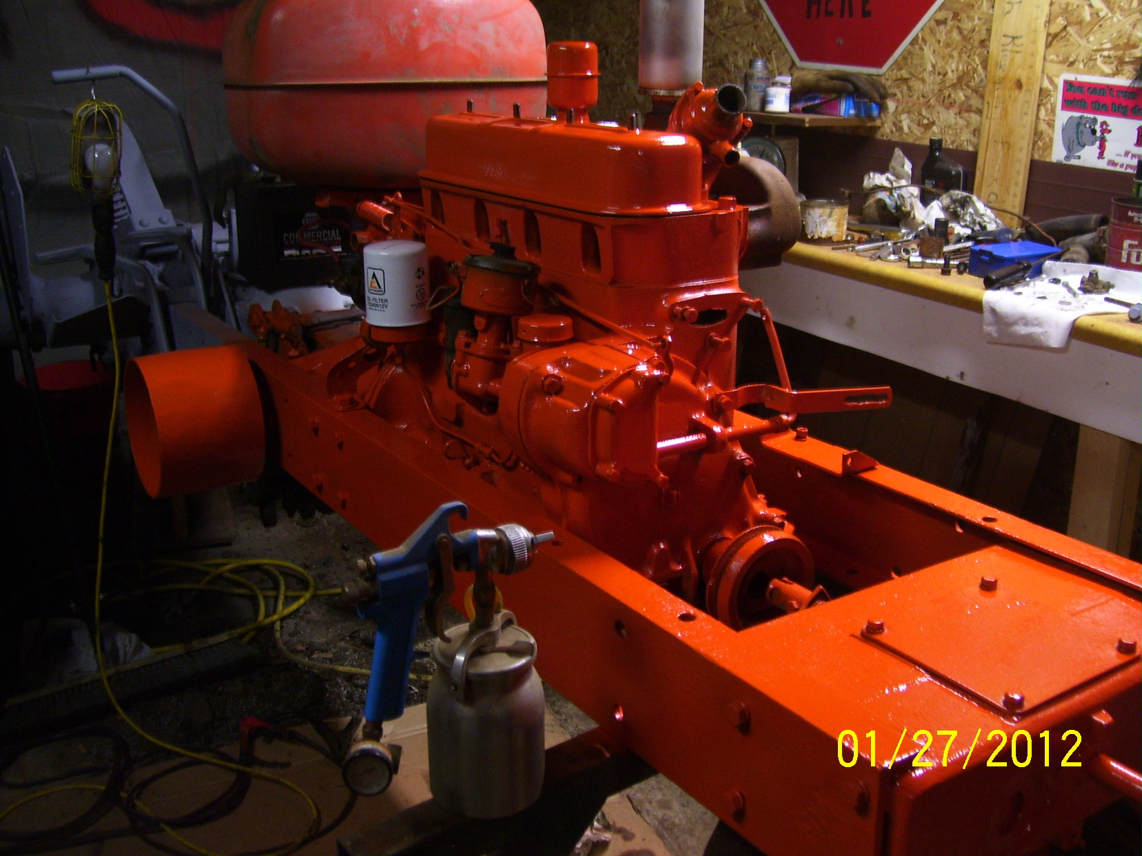

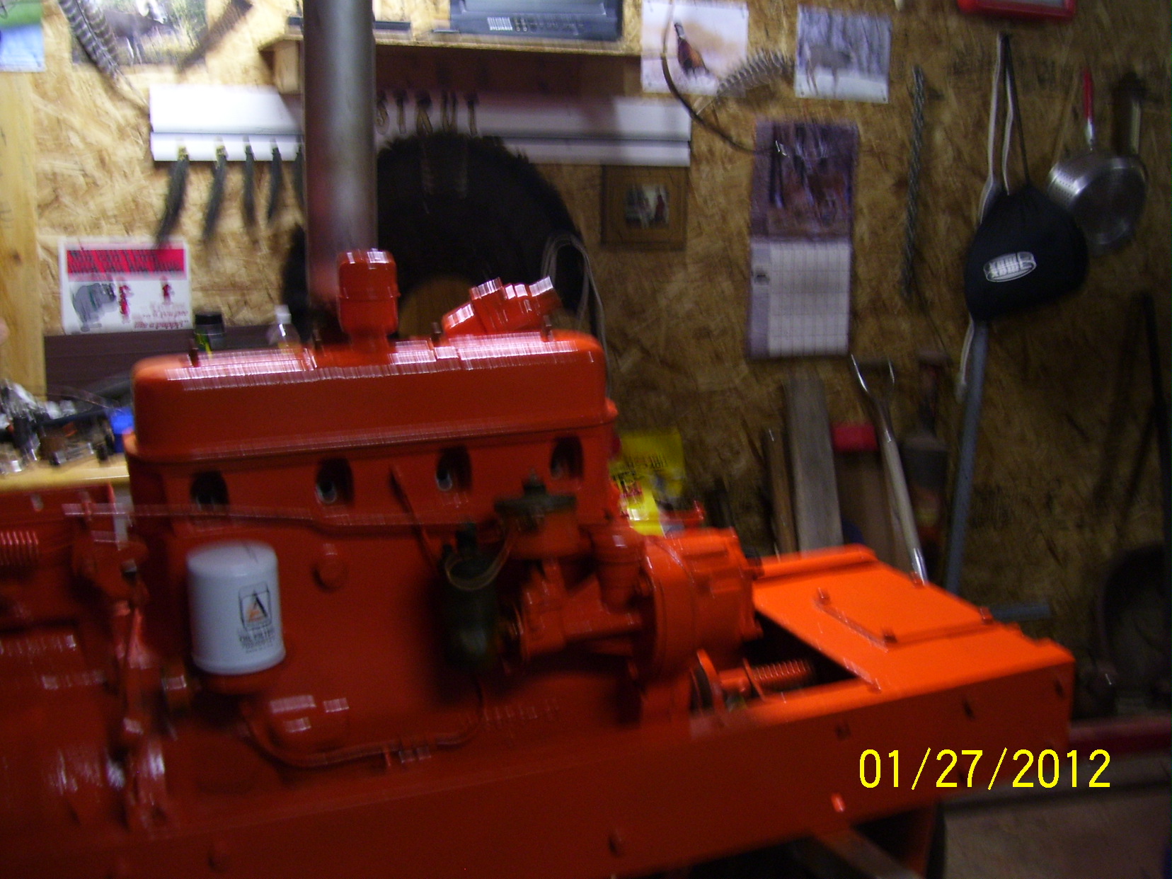

Post Options Post Options   Thanks (0) Thanks(0)   Quote smokey Quote  Post ReplyReply Direct Link To This Post Posted: 27 Jan 2012 at 7:31pm
Here's a couple peek pic's, the air compressor had an problem and shut me down todayCry nothing major just blew a fitting on the tank to regulator line so I had to order a new one as nobody seemed to have one Confused but I'll be back at it tomorrow with something like working on the starter as the starting it today didn't workAngry the starter is draging and needs to be cleaned up inside, put the tank on and take tank off OH what fun it is doing everything twiceLOL.

Post Options Post Options   Thanks (0) Thanks(0)   Quote R.W Quote  Post ReplyReply Direct Link To This Post Posted: 29 Jan 2012 at 9:01am
Looks like its coming right along for you!
