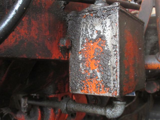

My Dad made a little square box reservoir for the WD.....I think that is 1/2" pipe that screws into the drain plug.
Keeping the fluid at the proper level on the dipstick keeps the fluid in the tank at the same level.
Been working great since about 1960 when he built the loader.
I use it all the time to this day.

Post Options Post Options   Thanks (0) Thanks(0)   Quote Brian G.  NY Quote  Post ReplyReply Direct Link To This Post Posted: 05 Mar 2019 at 9:31am
Here's the reservoir on my WD.
