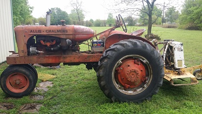

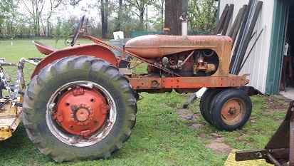

Post Options Post Options   Thanks (0) Thanks(0)   Quote mhankins Quote  Post ReplyReply Direct Link To This Post Posted: 26 Apr 2019 at 5:52pm
mhankins View Drop Down
Joined: 19 Feb 2019
Location: Arkansas
Points: 134
Post Options Post Options   Thanks (0) Thanks(0)   Quote mhankins Quote  Post ReplyReply Direct Link To This Post Posted: 26 Apr 2019 at 5:54pm
Not the prettiest girl in town,awkward getting on and off,clutch pedal hard to reach for a short fatty,smokes some,and hard to keep straight mowing,but I love the old thing!
 It do have a lot of character.

Post Options Post Options   Thanks (0) Thanks(0)   Quote Sugarmaker Quote  Post ReplyReply Direct Link To This Post Posted: 26 Apr 2019 at 7:30pm
m,
Thanks for the pictures of the 45! Awesome tractors! Yes to all the negatives. A longer left leg is mandatory on one of these. Hummmmmm Chiropractor always said I have one leg longer. I thought it was from some of the ancestors coming from By God West Virginia! Could be a genitic defect to run a WD series tractor?:)
