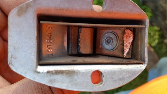

You can just remove the starter mechanical switch, no need to remove the whole starter. If you do want to remove the whole thing there is a keeper bolt on the left side (as sitting in the seat) and if you remove it the starter will slide back and come out. As far as the start switch goes, it has a large copper tab that makes contact with a tab on the starter when you pull the start lever. Sometimes the copper gets pitted and you can file this down some so it makes full contact. You are on the right track from your description. I would also suspect the starter or the switch since you have already cleaned all the connections.

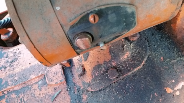

Sorry forgot to say its 12V system.  When I try to start it, the voltage doesn't drop at all, which means the starter isn't even trying to turn.  The contacts were pretty corroded when I pulled the switch off and you can see where they are making contact, because it's sort of wearing off at an angle (see pictures).  At what point do you replace that switch (and maybe the post going into the starter)?  The odd thing is that this slow starting thing just happened a week ago, it literally started great before that, then just started getting slower every time.  I put a little oil on the switch too, because it was hanging up a little, so maybe it just wasn't making contact all the way?

I bought a new made in the USA switch from AGCO yesterday for 25 bucks, I'm going to try swapping that and see if it makes a difference or no, since the contacts on my switch are pretty worn out...I will let everyone know how it turns out...I may file the post on the starter off just a little bit too since it's worn at an angle....if that don't work I will pull the starter and have it rebuilt probably, I don't have an extra $300 to drop on a starter now.  Thanks as always for all the help with the question.
