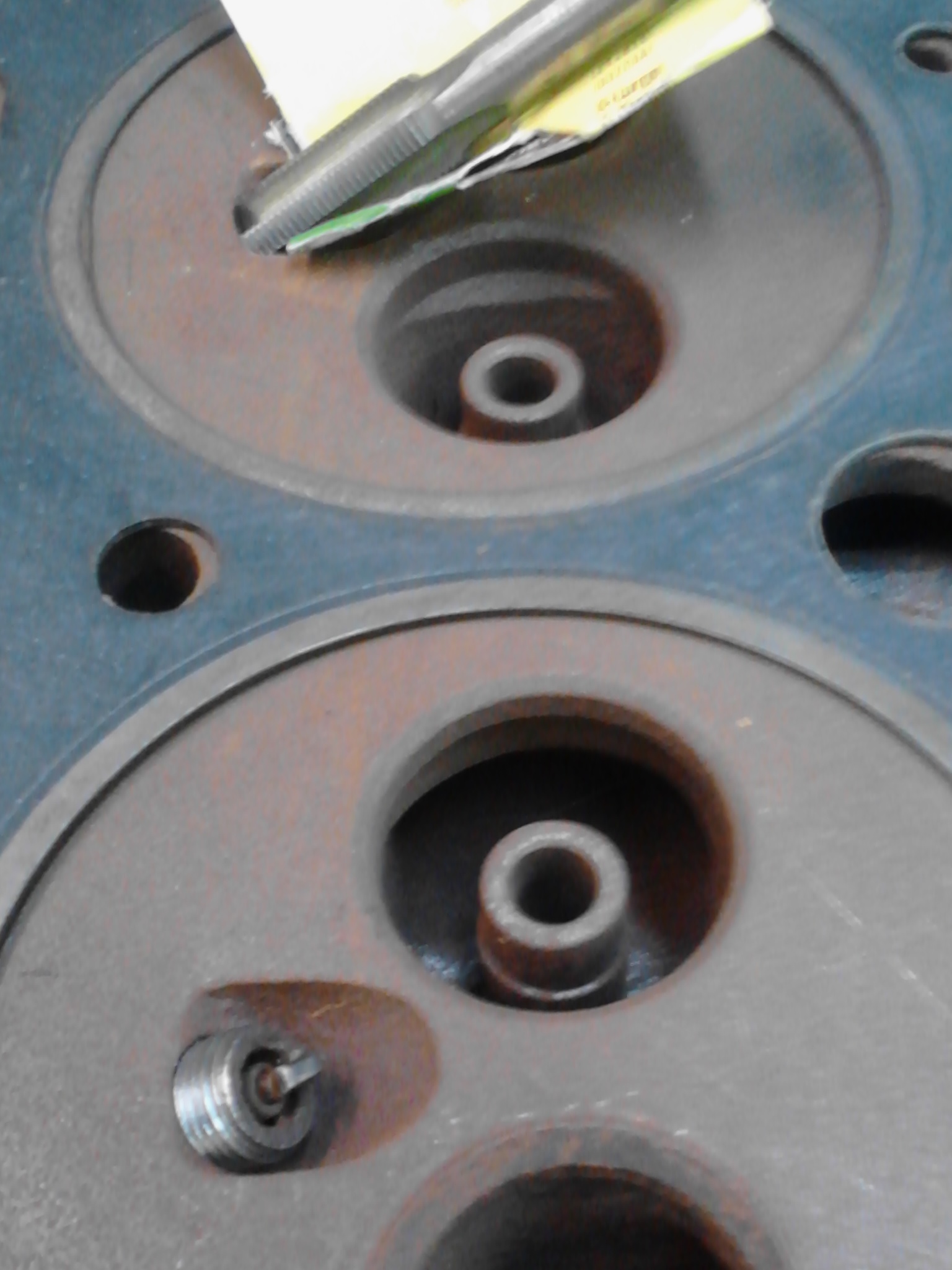

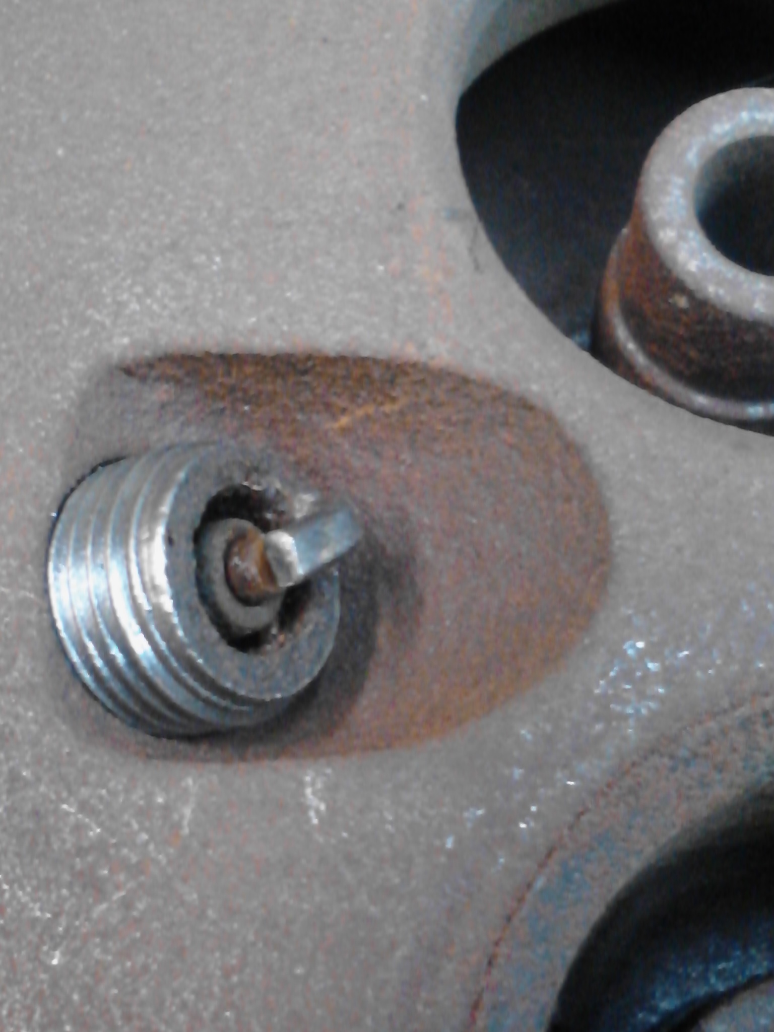

A picture of a 3/4" reach plug in a D-17 head.
Notice how the electrode can not touch the pocket.  Must be one helluva gap if pankey is refering to.
A WD-45 head with the through style sparkplug pocket, a 3/4 reach plug screwed in tight.  Again no way it is going to hit anything.
Again the same WD-45 head with a tap screwed in from the combustion chamber to show how the plug can not hit the head.  There is multi layers of cardboard pushed between the plug pocket and tap.  A 3/4 reach plug can never hit the pocket in any of these heads, even with the washer removed.
Ray Charles can even smell something fishy.
Edited by Rod B - 04 Apr 2012 at 2:01pm

Post Options Post Options   Thanks (0) Thanks(0)   Quote mlpankey Quote  Post ReplyReply Direct Link To This Post Posted: 04 Apr 2012 at 2:19pm
3/4 reach plug still aint sticking out past pocket . Piston would hit head before hitting electrode even in your picture.  You have a projected tip in the d17 and a non projected tip 3/4 in the other head. no back peddling  you with another picture wich makes a visual case of all three designs proved what I was saying. even used a gasket to show where the fire ring or sleeve edge is. Three Allis heads three different plug pockets which one does the guy have who knows .Rod B do you know? So the general statement plug would hit back of the plug hole on one of the three before hitting the piston on any of the three is correct . ps I have a 37 wc head that even has a different plug window also so really four AC designs. Would you like a picture of it . Also the back wall is steeper on the d17 and not as angled as much in your picture as the 45 so if a projected tip from the longer brand with a 35 to 40 thou gap is attempted and the electrode turns toward back steeper wall guess what.
