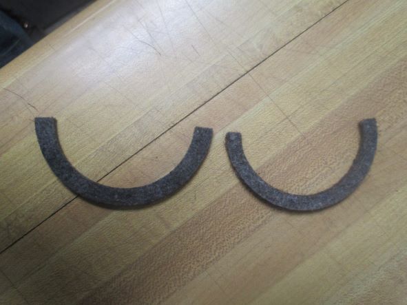

Glad to hear you watched Don's gasket video! Here is a pic of the Aftermarket (left) vs OEM (right) seals for a WC-WD45 part # 227120. You can see the difference in height and when you attempt to press these inside a circle of a set circumference, the thicker one will be longer. If you want the correct ones, we keep them in stock. Make sure you use the F gaskets also, otherwise you will have oil leaks. Also if you had thin paper behind the old felt seals, it is supposed to stay behind the new seals.
