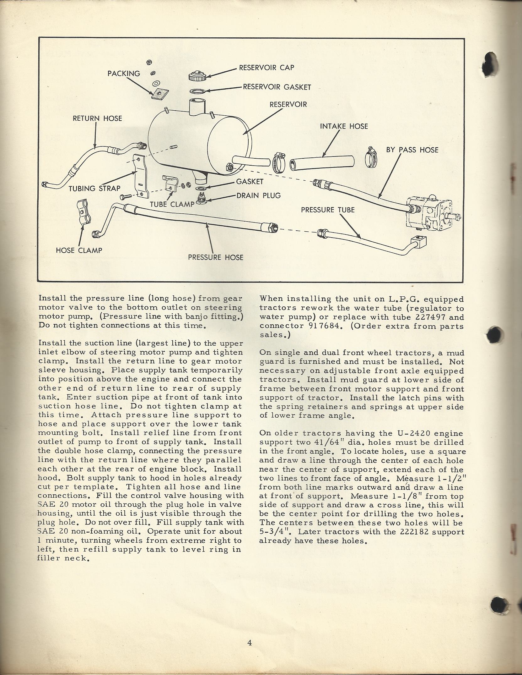

Anybody have a template for the WD45 power steering pump mount. what I have is pretty wrong. I see in the agco parts book it looks like the pump is located on the left above the generator and a idler pulley on the right. even a picture of it installed would help. I have a cobbled setup that the pump is directly above the waterpump and interfears with the radiator hose.

down sized this image

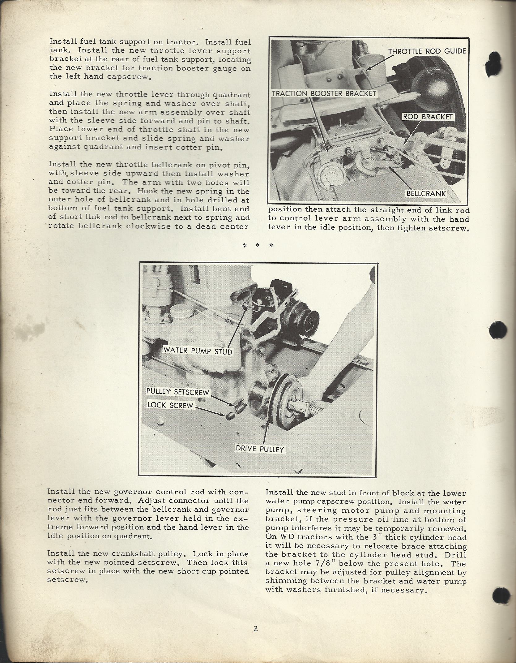

Post Options Post Options   Thanks (0) Thanks(0)   Quote JC-WI Quote  Post ReplyReply Direct Link To This Post Posted: 08 Jun 2018 at 10:29pm

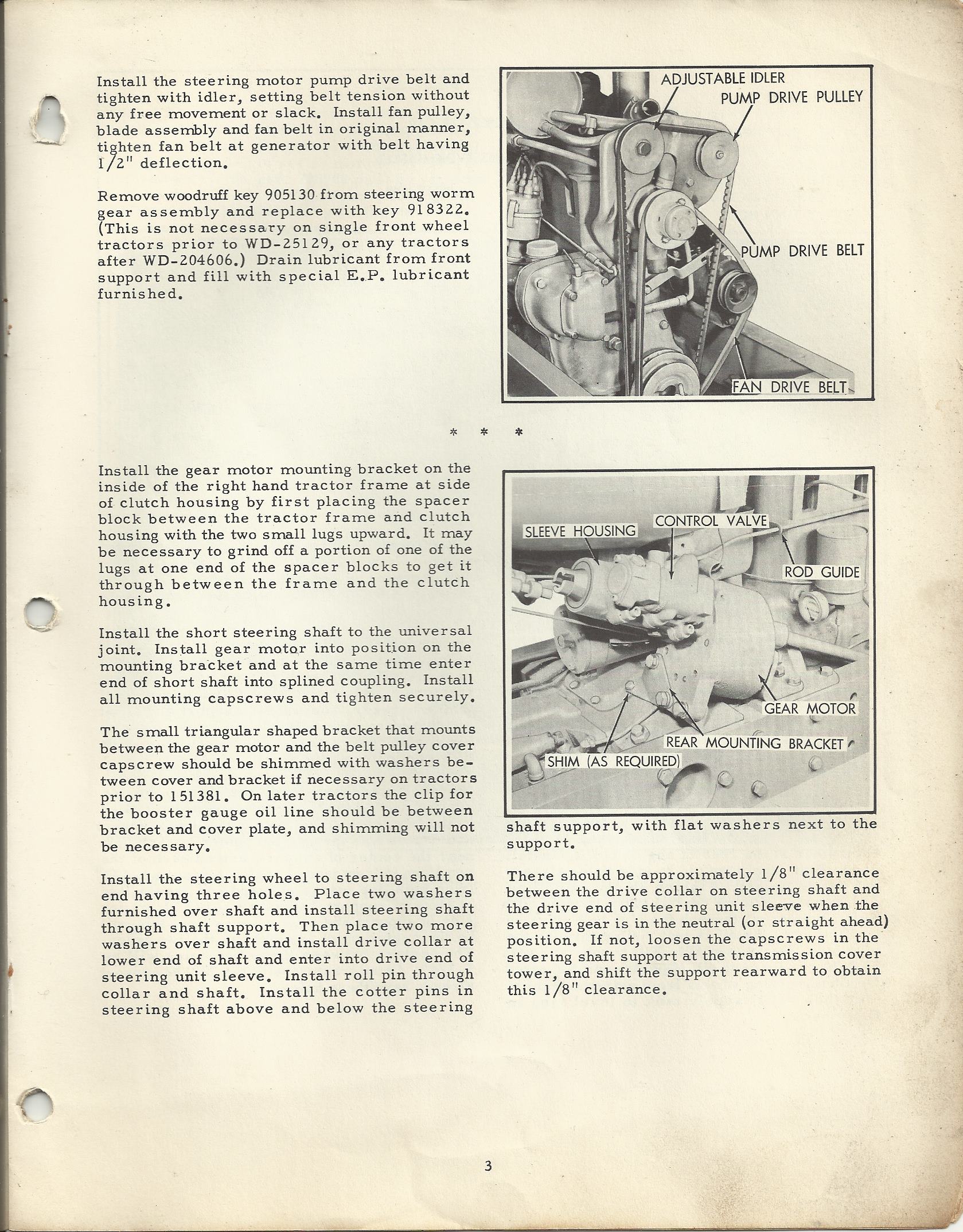

Post Options Post Options   Thanks (0) Thanks(0)   Quote JC-WI Quote  Post ReplyReply Direct Link To This Post Posted: 08 Jun 2018 at 10:30pm

Post Options Post Options   Thanks (0) Thanks(0)   Quote Dakota Dave Quote  Post ReplyReply Direct Link To This Post Posted: 09 Jun 2018 at 8:58am
The picture helped and I printed the SB pages and added to my service manual. these should help a lot I have a charlynn unit and a pump that looks a lot like the correct one. I've contacted Lon about the mount he'll sell so hopefully Ill have power steering fairly soon. as long as this works I'll put the loader back on this tractor.
