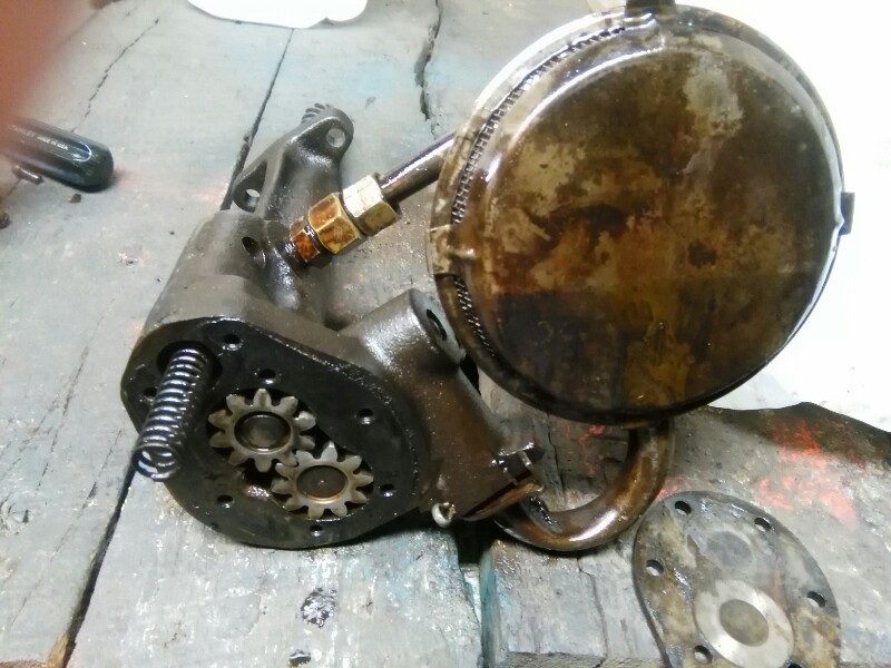

Got around to cleaning the oil pump for the WD45 engine build but noticed something. This pump has a internal relief valve. Is this from a D17?
Little back story. I bought a complete WD45 engine from my cousin supposedly ran fine 10yrs ago to rebuild. Tore it down and block was cracked. I got another block now. I just went and looked at the first block and it didn't have any modifications. There was a nut behind the relief valve in side of engine like they tried to make it stay closed or something. So I guess I need to find a WD45 oil pump to make this right.

This was discussed a few months ago. It will hurt nothing to use that pump in your tractor as long as long as it's a 10 tooth to match the wd45 cam. It must be because it was already in there. They stopped making the 45 pump so that is a replacement pump. It must've had a bad pump sometime and received an allis replacement.
You don't need to modify the block relief cable either. Wen it hits a certain psi, either he block or pump relief valve will open. It doesn't matter which. Internally, the pumps flow the same amount of oil.

No need to find a different oil pump.   When they switched over to the full flow pump, Allis basically discontinued servicing or providing the old style pump in the parts department and said to use the newer pump with the built in relief valve in the older engines.  Just need to change over the pump drive gear to match the camshaft.  Id you look at AGCO parts book, you will see that the part number for a complete pump is the same from a WC through a 175...but you have to order the gear separately.

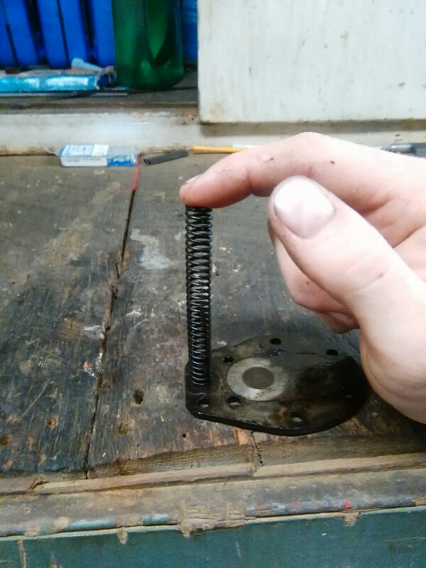

Oh ok that makes me feel better. Is that spring supposed to be riding on the end plate? That doesn't seem right. I didn't see anything fly out when I took cover off. I looked in my D17 book and it shows a plunger I suppose you would call it on both sides of spring. Clearance between gears is .011 I forgot to check pump body to gear.

The guys are spot on, you have the up-dated pump. the spring rides on the end plate with the plunger below the spring in the pump housing, lots of WC/WD/WD45 engines had and some still do have a nut or washers behind the plug holding the spring in. I plane the end cap back flat and note the gasket go's around the spring so the oil can come out with out blowing the gasket out. if you look at you pic on the side of the pump housing below the spring you can see the relief valve drain hole. the plunger is just below that hole. If you make the cover gasket use the same thickens gasket as the old one. I true the cover before installing it. bend one of the four tabs on the intake sump and slide it sideways off the intake then clean the screen on both sides of it.

Oh ok so spring sets just like in this pic. I have .011 between the gears and .006 between gear and body. I can also move shaft back and forth ever so slightly. With all the money I have in this engine build this little bit of wear is bothering me alot. What do y'all think?

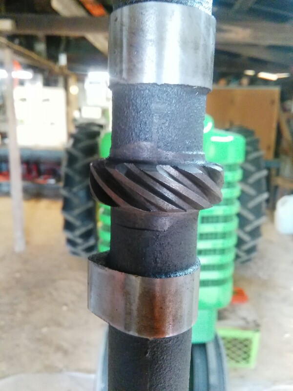

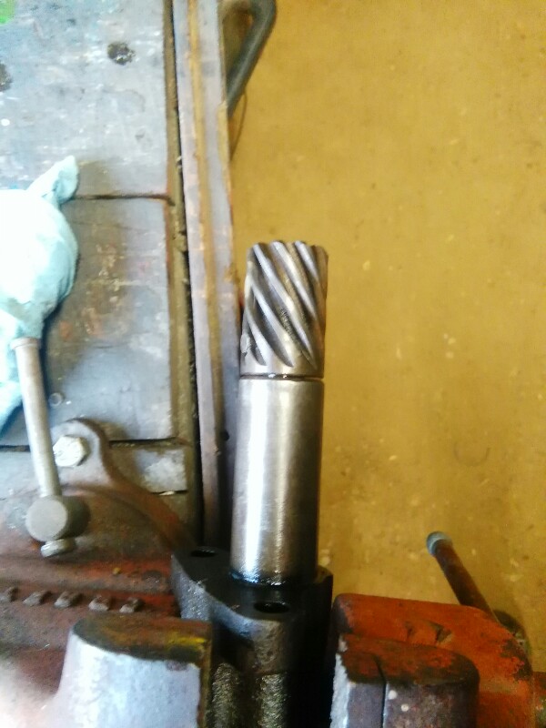

I think you are still OK with the pump housing and gear wear, yes they have some but if you can even find a replacement pump or even the gears they are going to be very high priced. I'd plane the cover back flat and go down it-tell the gear markings are gone.
Post a shot of the oil pump driven gear and one of the camshaft oil pump drive gear, Have you pulled the relief valves out of the pump and block and looked at them?

Gear on cam and pump look good. The relief valve is out of block. One in pump is currently stuck. I'll get a pic of it a little later today.
Book says .008 max between body and gears. I have .006 It says .015 max backlash I have .011

I have the Agco book and IT book. On the body to gear spec it's close to the max which worrys me on about a $4500 engine. Here is pics of the gears. It's kind of a toss up for me. Anything close to out of spec I have been throwing it away or fixing it. I still have to get a better crank as well. The one I have is .020 on mains and .010 on rods already. It would work but with the theme I've been going with its not good enough...lol.
