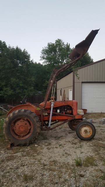

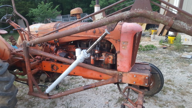

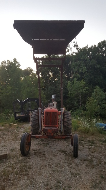

Post Options Post Options   Thanks (0) Thanks(0)   Quote AJ Quote  Post ReplyReply Direct Link To This Post Posted: 12 Jul 2018 at 3:37pm
Well her she is. Works great! Probably raised and lowered it a couple 100 times now and no issue. Very little seepage but that will only get better the more the seals swell up. She ain't no beauty queen but will save my back a lot of work.
