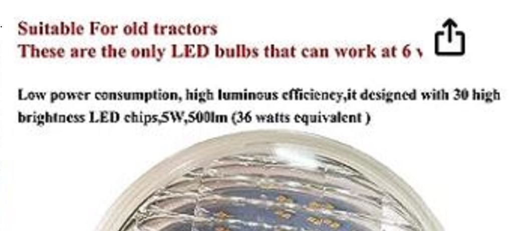

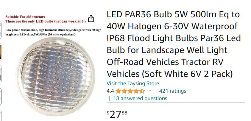

Most of the new "LED" type bulbs will work 6-30 volts or 12-80 volt systems.. You can buy one with a case already installed and just BOLT ON... This one is SUPPOSE to replace your original bulb and use the old case.... maybe ?? .... from AMAZON..
I think the "PAR36" mean it puts out the equivalant of 36 WATTS  ( on an incandesent bulb)..... but  LED only pulls 5 Watts... or less than 1 amp each on a 8 v system.

Post Options Post Options   Thanks (0) Thanks(0)   Quote steve(ill) Quote  Post ReplyReply Direct Link To This Post Posted: 28 Jul 2023 at 7:52pm
this is what it says in the upper left corner...
