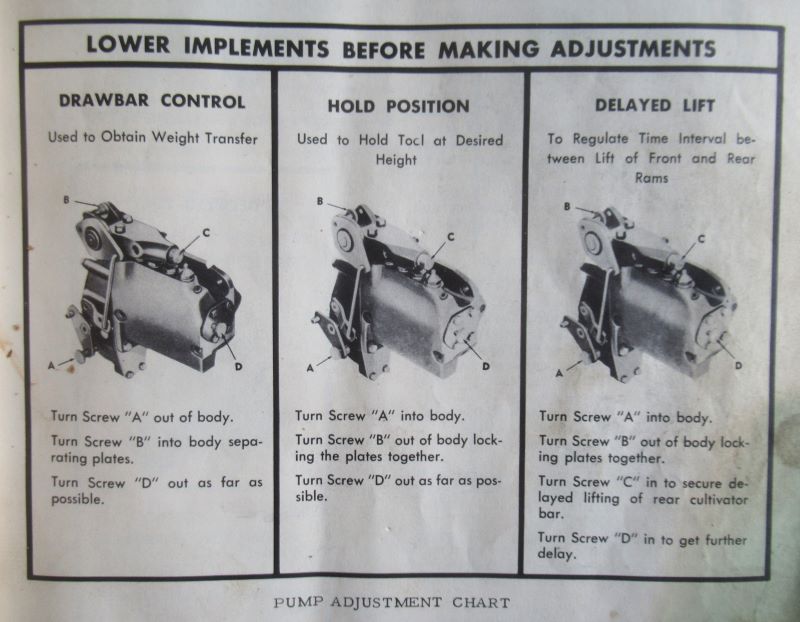

Not difficult at all to adjust the screws on the hydraulic pump itself to have "HOLD" position in the center of the hand levers stroke. There used to be a large decal on the side of the battery box showing you how to set the pump for whatever job you're doing. Also the owners manual has this information.

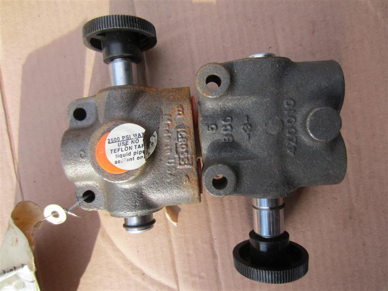

There is a detent in the quadrant. It takes some time with the hydraulics to be familiar with it. Move the lever up and down and see it you can feel it. But as was said find out how to set the pump. I have a loader on my with a diverter valve so I can use either the loader or the rear implement. If I want either one to stay at a certain height I which the valve to the other one. Shuts of the pump to that one and it stays where I put it. Maybe not right but it works for me.

Post Options Post Options   Thanks (1) Thanks(1)   Quote Brian G.  NY Quote  Post ReplyReply Direct Link To This Post Posted: 28 Aug 2024 at 9:34am
Of course the good Doctor is correct.
Unfortunately, most original tractors and even some "restored" tractors no longer have that chart on the side of the battery box.
So......here is the chart as shown in the owner's manual.
BTW, the detent is located here rather than on the Quadrant.

Post Options Post Options   Thanks (1) Thanks(1)   Quote Brian G.  NY Quote  Post ReplyReply Direct Link To This Post Posted: 28 Aug 2024 at 1:24pm
mdm1,
A diverter valve has been working for me for years as well!
I have mine connected to a lever within easy reach.
I have a backblade and a loader on my WD at all times.
Edited by Brian G. NY - 28 Aug 2024 at 1:36pm
