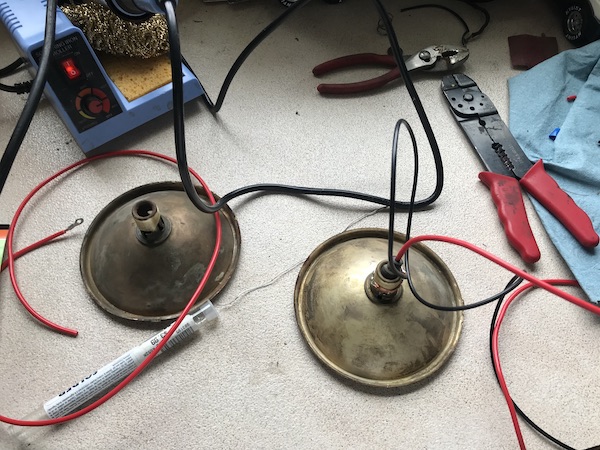

The ground is rather iffy on those lights. The reflector contacts a little brass tab which is riveted to the headlight shell. Old age, corrosion and rust all take their toll and the ground is no longer continuous.  Best is solder a wire to the bulb socket as has been recommended and attach to a good ground point.  If using the thumb screw as the ground, make sure it's not rusty and makes good contact with clean threads and the light  tube.

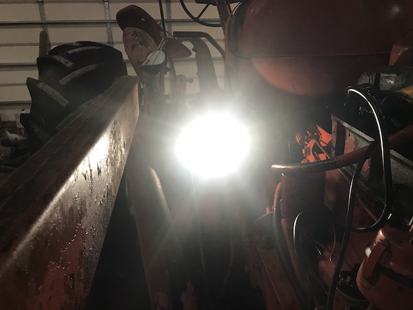

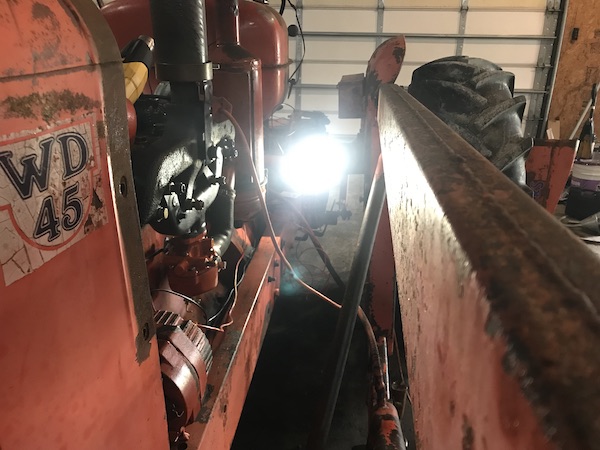

Took your all's advice and rewired these guys completely today. New contacts to the bulbs, new grounds on the sockets. Works perfectly! Thank you all for taking the time to offer your advice here =D
