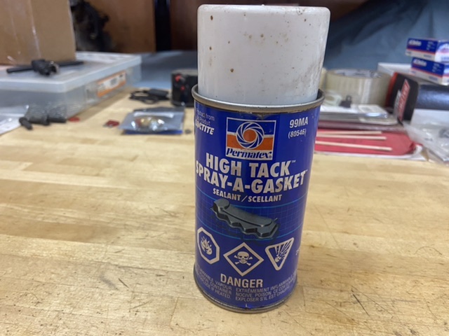

This what we used on Chev V8 motors with the stainless steel gasket or shim. It was about .011 thick if my memory is ok. Sprayed both sides of gasket, let it get tacky and assemble. Never any problems.
Two weeks ago I did a head gasket on a 1955 IH pickup.  BD240 in-line 6 cyl. I used a felpro gasket but different from what I am used to. Was stainless on the bottom and felpro blue composition on top. I sprayed the bottom and put it together. Sure hope it works. I am going to try to get the hylomar stuff that Doc is recommending. 😀
Edited by Ed (Ont) - Yesterday at 6:26pm

Yes. Any felpro composite goes together dry here. The IH one was stainless on bottom so just sprayed the bottom half.  Hopefully will be good! 😀 I like the felpro gaskets.
