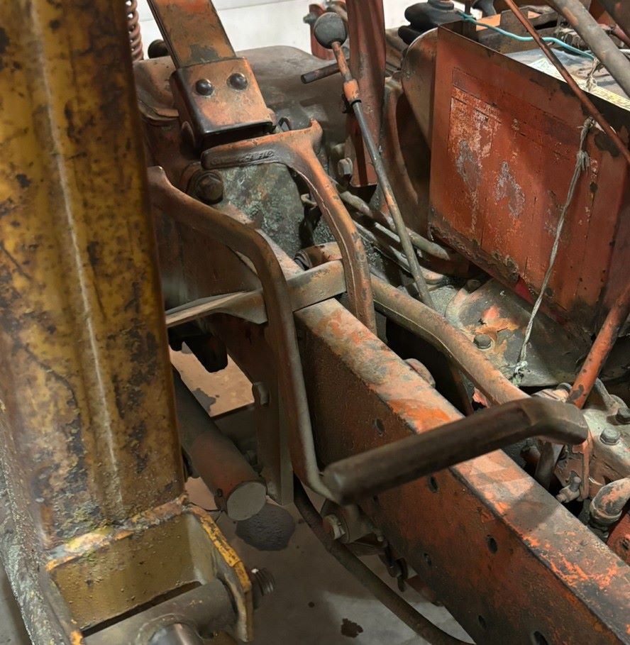

Hey All,
Purchased a 1956 WD45 - Gasoline.
Ill explain the issue, then give details of what I know thus far.
Hand Clutch is disconnected.  Handle is all the way forward (basically horizontal) and stuck.  I haven't tried any force other than my own hand pulling up on it.
Question is this:  Is there a reason someone would have disconnected the hand clutch and left it.  I'm assuming it just sat this way for so long that it has seized up in that possition.  Second question is, what do i need to think about/do before I try to reconnect it.
I plan to take off the battery box and see if anything appears broken or seized before trying to opperate the clutch.  But in theory the clutch handle shouldnt do anythign without it being connected to the other shaft right?
If everything goes well, and freely moves, I know I might need to look at adjusting the spacers and such, but when and why would I need to opperate the hand clutch?
As of right now, the tractor drives in all 4 gears plus reverse.  The PTO engages and disengages the brush hog. Drove it 15 miles home Saturday with no issues driving in 4th gear about 14 miles an hour.

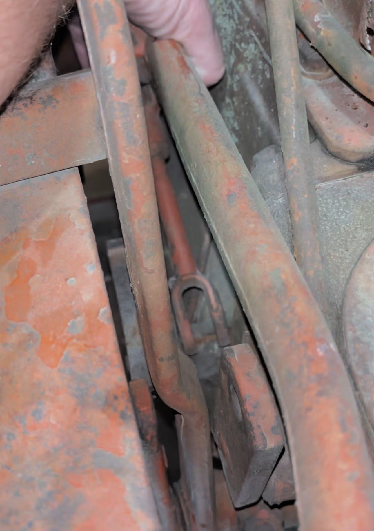

Pictures attached of the connection.

The Hand Clutch Lever would normally be vertical.
It should pivot freely on the shaft which it is mounted.
The hole in the lower end of the Lever should be connected by a short Link
facing forward and connected to another short Lever.
If either end of this short Link is disconnected, the long vertical Lever
should pivot freely fore and aft.
Gary

The lever could just be froze. It pivots on the pin. You can usually use large slip joint pliers on the short lever to engage / disengage the clutch. Heat the lever up and get it free.

Maybe the connecting pin on bottom of clutch handle came out and previous owner didn't know what problem was? If handle moves freely, put a pin in connector link and test handle by moving forward/backward to see if clutch engages/disengages.

Why anyone would want to disconnect the hand clutch with a loader on there, is beyond me. Although a couple reasons come to mind. One could be that the handle was hitting the loader upright. Another could be that there is issues with the hand clutch, (possibly throwout bearing bad?).
A good reason to have the hand clutch working is, it gives you "live power". When you use the hand clutch, the hydraulics and pto keep working. When you step on the foot clutch everything stops. Well, kinda stops when you are brush hogging. When brush hogging, if you step on the foot clutch, the momentum of the blades will turn the pto. Which in turn, powers the transmission, and propels the tractor forward, (or backwards, depending on which direction you were going when you attempt to stop). The hand clutch separates the transmission from the pto and hydraulic pump. Learned that the hard way 27 yrs ago. Was brush hogging with a H Farmall. Stepped on the clutch and the momentum of the mower pushed the tractor ahead another 10', and ended up running into the barn.

Maybe the hand clutch was slipping so it was locked up and the lever disconnected
