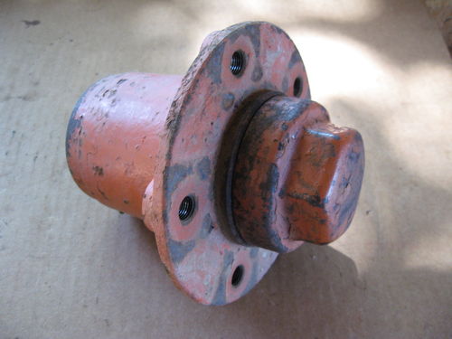

I was wondering what the right way is to take apart the front hub on a WD45 WFE.  Im assuming the hub nut is threaded but, I don't have a large enough wrench/socket.  How is this done?  Thanks

Pipe wrench, strap wrench, large adjustable wrench, C-clamp, pipe clamp.Thumbs Up

Pipe wrench. Take cover off , then take off the nut with the cotter pin then bearings slide out

buy a bigger wrenchLOL If the hub cap on the one pictured needs to be taken off, clamp the hex cap in a vice and put a couple wheel lugs in 2 holes and put a pry bar between the lugs.

Thanks guys.  The one pictured is not mine, mine are still on the tractor.  Ill have to see if I can borrow a chain/strap wrench.
