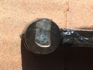

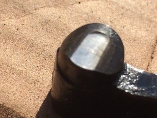

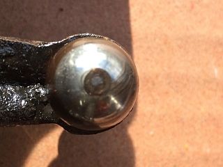

Next I pulled the rocker arm assembly off to inspect the surfaces on both ends of the arms to see how much wear is there. Here are 3 photos, the first of the lifter end, the last two on the valve end:
The lifter end surface looks fine to me, but you can see the wear on the valve end surface. All of the rockers seem worn to the same degree. So the question of the morning is: is this enough wear to justify regrinding or even replacing the rockers?
Thanks for your help.

Very normal wear on this age engine and certainly renewable. Depending on whether your're better with a file or grinder you can do them by hand if you're needing to save a little money. The best way to do it of course is to have ground by the head shop. I did my 45 by hand, taking my time, and it's been 5-6 yrs. now and no problem at all. But Joe and I think alike and pinch our pennies, Joe because he has money, and me because I have none. LOL The condition they are in, you really do need to resurface them. You'll get a better valve adjustment, more power and it will run smoother. PM me if you have any questions.

There's some penny pinching going on here as well! I'm going to compare pricing for a machine shop repair vs new and then think about whether to try this on my own. Smile

Today I pulled the rocker arm assembly, took photos, and disassembled it so I could grind the rocker arm pads. After studying the pad shape a LOT, I used the side of a fine wheel on my bench grinder - all eight done in about 5 minutes using light passes rotating the arm against the wheel. Reassembled the rocker arm assembly and re-installed it. I've set the clearances to 0.013 cold....I believe the spec if 0.012 hot. Once all the fluids are back in the old girl, we'll see how it sounds!
