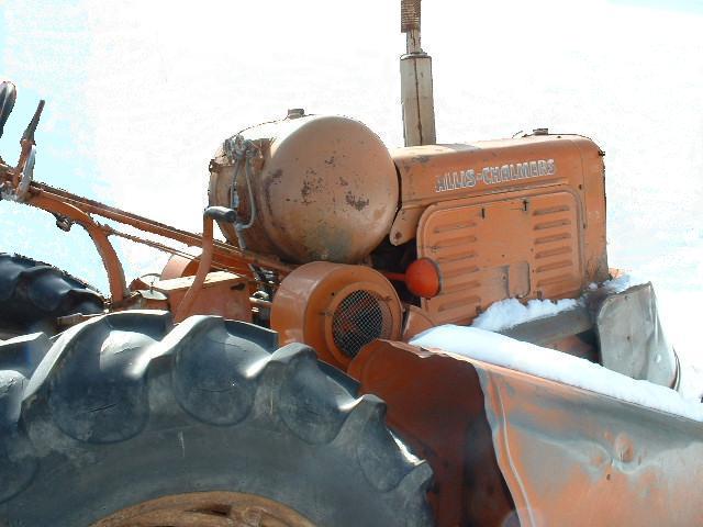

Our WD had the propane put on back in 1960 and it has been run on propane vapor for 55 years that it has been here. Plowing or winter work, we just turned the vapor valve on and went. and the fuel did vaporize fast enough to use full power, couple different times we turned the liquid valve on when we were pulling hard to see if it would make difference, and it did not and that was when we were chopping corn and when we were plowing. the area of the tank is greater laying down than it is standing on end as in the JD... and the tank is out front where its always cold where as the WD had the tank where engine heat could get to it.
Though I do admit that when we were driving the old tractor home from picking corn and the temp was -10, you better have 20% fuel in it or you would be pulling the hill in third gear with your load of corn, and if the needle was hanging at 5%, it might be second or first gear.
