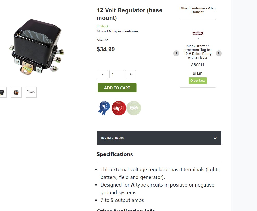

Will a regulator from a wd45 diesel work?
I have to order from Dj tractor but they don’t list how many amps it is…
Points: 90597
Post Options Post Options   Thanks (0) Thanks(0)   Quote steve(ill) Quote  Post ReplyReply Direct Link To This Post Posted: 07 Sep 2024 at 2:11pm
https://www.steinertractor.com/ABC185-12-Volt-Regulator-base-mount
Edited by steve(ill) - 07 Sep 2024 at 2:13pm
55allis View Drop Down
Joined: 30 Jun 2020
Location: Griswold Iowa
Points: 1329
Post Options Post Options   Thanks (0) Thanks(0)   Quote 55allis Quote  Post ReplyReply Direct Link To This Post Posted: 08 Sep 2024 at 5:32pm
So what is the lights terminal?
Do you plug that in to the light switch?
Sorry if that’s a dumb question but I’ve never wired a regulator..

You can pick up power anywhere for the light switch. I, personally, like to pick it up from the ignition switch, so the lights go off with the switch, so I don't forget the lights on and kill the battery.
The downside is that you can't run the lights with the switch off.
To answer your question, the lights are not wired directly into the regulator.

L terminal is just another BATTERY terminal.. You dont need it... Just wire the LIGHTS to the battery or ignition switch as WF said .... "L" allows you to pull power from the battery without going THRU the regulator...

That makes more sense… lol
