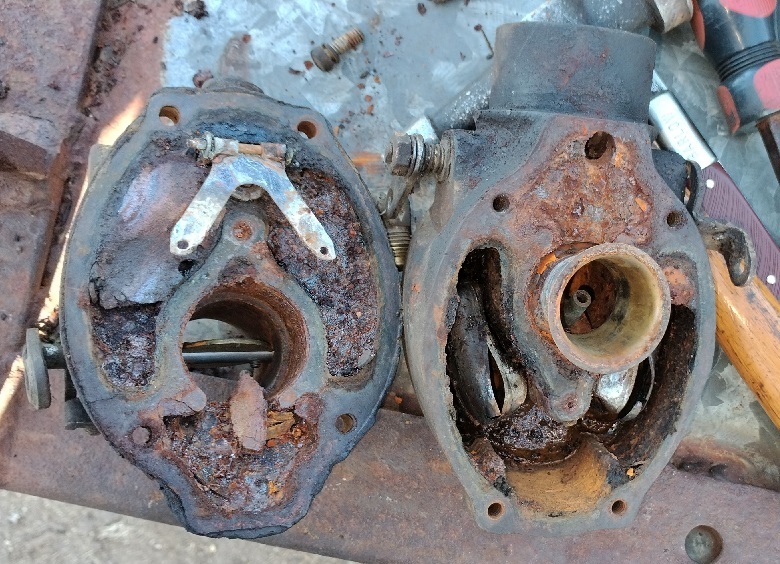

Haven't run the old WD45 for about 8 years, put new head gasket in and started cleaning the fuel system. Cleaned tank out and was running gas through the TSX464 carb and it didn't seem right. Took the carb off and split it. This is what I found. AARGH! Never thought I would see this.
 So, The old WD45 has the overbore pistons and wondered if it should have had a slightly larger carb on it, like a D17 carb?
 This one really looks like a challenge to fix up again, though I got floats and repair kit coming for it, but if somebody has a good carb ,  I would be interested in it.

You might resurrect this carb except for that big chip out on the lower left side of the image. Perhaps a game of JB Weld?? Water and ice in there did a number on it.
I think you might be seeing remnants of a split open float.
You might be surprised how that would clean up with a glass bead blast cabinet.

Just find a good used carb. By the time you think you can save this one it will have jets you cannot remove and the cost of the parts will exceed a different carb anyway.

Heck, that looks like some of the Carburetors that come in here for rebuilding. Some of em' look like they've been laying in the bottom of a pond!  LOL! I get some of em' whipped back into shape though.  I have a few 464 cores. Nothin' rebuilt yet, but if interested, I can probably put one together for ya. Your call.

That there carb is a nasty one for sure. May end up being a parts carb at best?? Havent seen one that bad.

Ultrasonic Cleaner might help see what you are actually working with. Harbor Freight has an inexpensive option.

there is enough of those around, as Dr Allis says, it aint worth messing with. But here is my question, how'd that happen? both floats leaked, then froze and burst? I suspect that you are going to find some damage in one or two cylinders too!

The problem is the Ethenol. That crap when it sits for a long time it turns fuel to goo. Works almost as good as super glue. He probably pulled the two halves apart and the goo held the pontoons in the float bowls and when he pulled it apart the floats stayed in the float bowls and the pontoons ripped off.....Seen that many a time.....

 Next step was to add gas and found the tank to be rusty inside and empty. The tank was never rusty until it sat the last years. Gas cap doesn't fit tight anymore and must have gotten water into the tank and went down to the carb... and it didn't help that the tank probably had the cheap alcohol fuel sitting in it. over the period of time rusting and corroding things. Thus here I am with the problems created by not repairing the tractor right away when the head gasket had failed.... or even taking steps to mothball it to preserve it for a later date such as draining the gas out of it. Unhappy
 Steve NJ, You are right about the ethanol in the rotten cheap gas, and the floats were corroded off before I took the carb apart.
Cleaned the carb up some, now to soak it for awhile to see if the jets will come loose...
But what the rebuild Kit I ordered did not include was the float hanger.  Notice the insert in photo.
Does somebody have a new hanger and rivets that I can get to replace this grungy old one?
 The Ultrasonic cleaners look like something that might work good for cleaning, and I was thinking about the electrolysis cleaning method too.
Hope I get the jets out easily. and the reality is...  Confused probably not... Maybe think positive, and they will screw right out. Wouldn't that be nice. LOL

HEA... I little solder and you will have them floats right back in shape !!  Wink Thumbs Up

That Carburetor can be saved, but the ole' girl is gonna need a ton of work. I'm lookin' at the lower bowl. Is that a crack in the bowl or just a stain?  If that's a crack, you're probably better off getting another 464 core to rebuild with the issues it has. The float pivots I don't mess around with when I'm rebuilding customer Carburetors. It would be cheaper for the customer to me to replace the upper section then spend an hour or so bench time trying to fix that pivot. I toss those bad boys. Being its your own Carb, you could spend the time to repair it if you wanted to. The problem is, if the holes aren't true to one another, the floats will either move around, or stick on the pivot pin in the bowl causing possible flooding issues. From a rebuilders point of view, it's not worth the aggravation that me and the customer would go through to try to repair a problem like that. There's plenty of 464's out there....   HTH

No crack in the bowl, Camera enhanced the hard scratches from busting the rust loose in the reservoir.
  With your information on the float pivots, new plan, clean them up and tin/silver solder little washers to the outside of the posts and then drill new hole through tight enough to hold the pin firm. No removing the bracket. Big smile
