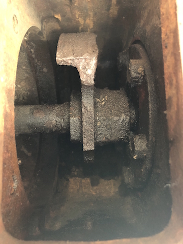

One of the things I've found on this new to me WD45 is the left brake not working . Looking up through the inspection hole at first looked like broken pieces of brake lining blocking the hole, once I looked a little better it turned out to be a shattered brake drum. I can't imagine the ruckus that must have caused. I made the mistake of dislodging a few Pieces  from the bottom which  jammed up against the broken drum and locked up the rear wheel, which led to having to remove the pin and shoes in order to move the tractor out of the garage. It wasn't the project I thought I was doing next, but had to be done , Now I need to find a replacement drum and re-line the shoes before I pull the final drive. Good fun.

Is this type of drum failure common? I was surprised to discover it shattered like this.

Not sure how common the problem is but I did find a drum with cracks and had to replace it on the WD45 I completed a year ago. Some pictures on my thread. New drum was about $80.00 I believe. I got mine from Sandy Lake.
Yea its not a fun job. Sounds like you got the lower brake shoe pin out. That can be the worst part.
Also while your in there that far, its not a bad idea to consider replacing the seals that keep the differential juice contained. Also if you have time money and energy, its is good to do both sides, then everything is all ready to go for another 70 years!

Once the final is removed, and what's left of the drum knocked off.
A good way to get the remaining hub off is.......
Find a good tapered-end punch. (~ 5/16 dia tip works good)
Select a corresponding drill and drill a hole into the hub over the key, but not through the key.
Support the hub on the opposite side with a heavy buck; a third hand is ideal for this.
Or lay it down on an anvil or something that won't give.
Start the punch in the hole and give it a few substantial whacks with a 2# hammer.
Hub should crack along the keyway.
The idea is to make use of the taper to force the hub to crack apart.
It's helpful to use a thin grinding blade to slice into the hub as deep as possible above the key.
We used the punch method for all of our brake jobs on A-Cs with those type of drums.
There were plenty of cracked drums to be found.
Good advice from Sugarmaker.
IIRC, the axle seals were leather.  New ones will be rubber,
Installing new drums can be a challenge too.  Best to uniformly heat them up and slide on.  Make sure to they are seated on the round ring.  A long pipe that will fit over the axle & sledge at the ready will help to drive it home.
Worst case; remove axle from final housing and use a hydraulic press to do the above.
Keep track of all shims !

I have suffered the drum failure on my wd45.  I have found a bunch of videos by Nash Summers on Youtube.  My question is can the assembly with the bull and pinion gear and the shaft with the brake drum be pulled out and then deal with destroying the pin at the bottom should it not come out for me.  I am thinking that pin might be bent or damaged as something was making noises and vibrations before and after I decided to tow it instead of driving.  Looks like about 5 or six inches of the outer portion broke off. Some pieces came out but some there is a piece too big to come out the hole at the bottom.
