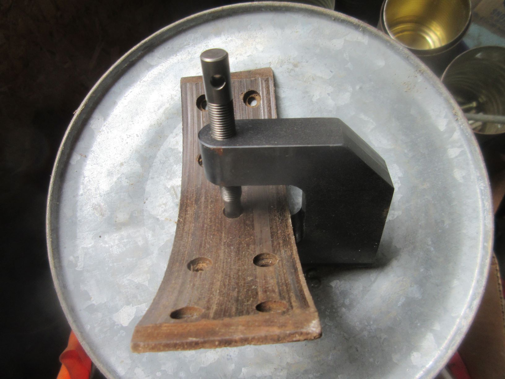

Post Options Post Options   Thanks (0) Thanks(0)   Quote Brian G.  NY Quote  Post ReplyReply Direct Link To This Post Posted: 07 Apr 2019 at 12:26pm
Tim,
I went out to the barn and found a brake lining.
I wanted to locate a shoe as well but couldn't
lay my hands on one readily.
If you saw my barn you would understand why.  LOL
It appears that the throat on the Aircraft Spruce rivet tool would
be wide enough to reach the center holes even if the lining were
installed in the shoe.
How far are you from Cobleskill?
Maybe I could come up to your place and I could try out my
rivet tool on your shoes. I don't have any brake jobs lined up
and I could then see how well it works in case I ever need it.
Wow....I downsized that pic but maybe not quite enuf!

The lining in my picture came from a tractor I "parted out".
It is a little worn but I kept it as it seems to be made of better stuff than I
have seen in aftermarket linings.
Unfortunately, I have only enough for 1 wheel; the other one was not worth saving.
