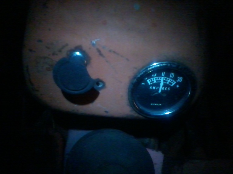

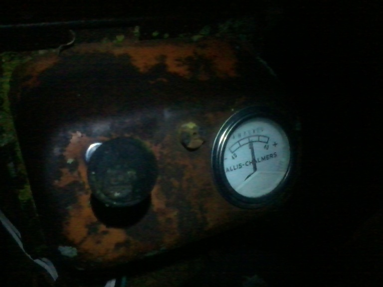

Here are some poor pics in the dark just taken now.
WD with white face gauge, and the WD45 with the Niehoff gauge.  Should have pulled the light switch on for a lighted gauge picture.

 Oh and the WD gauge is a 40 amp gauge and has the original 6 volt generator on it, and the WD45 has the 30 amp gauge with a Delco Remy Delcotron alternator. LOL
 Just pick the one you like the best and put it in...jmo
