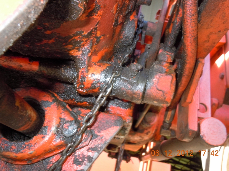

3) Would someone be able to post some pictures that show the correct routing of the chain down to the snap-coupler?

Still looking for more info on the chain itself. What type of chain and what length? Still looking for someone that could post some pictures of the chain on a WD tractor. Pictures are always a great way to see how something goes. Thanks.    Jim

Found the same type chain at the hardware store.Don't know what it's called.Like alot of dog chain where they take a length of wire and bend the ends back to the center and curl them around center lenght of original wire.Any SMALL chain would work. These are small wire,about like baling wire.

Although you didn't ask, the aft face of the snap coupler bell should not rotate more than 10 degrees up or 10 degrees down from its vertical plain (check it with one of those swinging indicator roof pitch protractors; cheapy from the big box store). If it does it has wear marks into its top side surface and needs to be welded flush. The accidental release happens when the bell has worn and rotates up or down too much and that makes it difficult for the release to release using the release handle. Guys would shorten the chain to get the release to work like when things were new. A few more times of shortening the chain and when the aft face of the bell would rotate up it would cause the chain to be pulled and that would cause the hook to be pulled down and the next thing the plow would be on your back. Be careful when you install a new chain. The hook should not move towards release when the bell is rotated. If you are going to install a bell check for wear in the top surface and weld it smooth before you install it.

Maybe these pictures will work.
Dave

David,   Thanks. That's what I was looking for. Your pictures should help my son figure out how things go.      Jim
