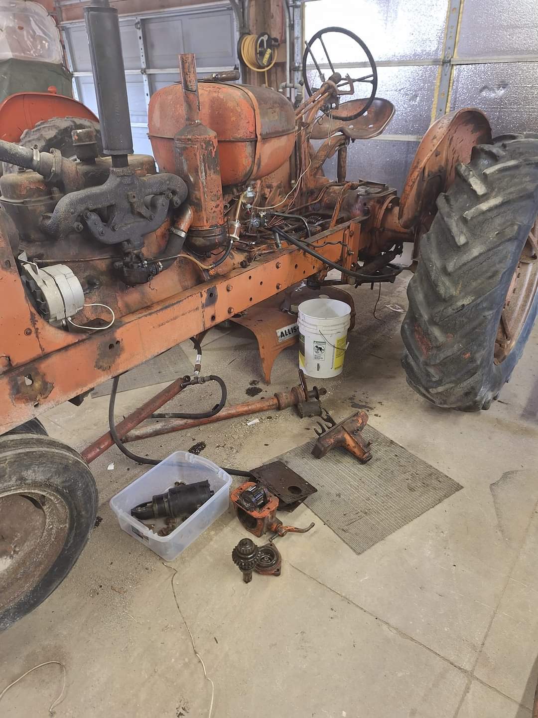

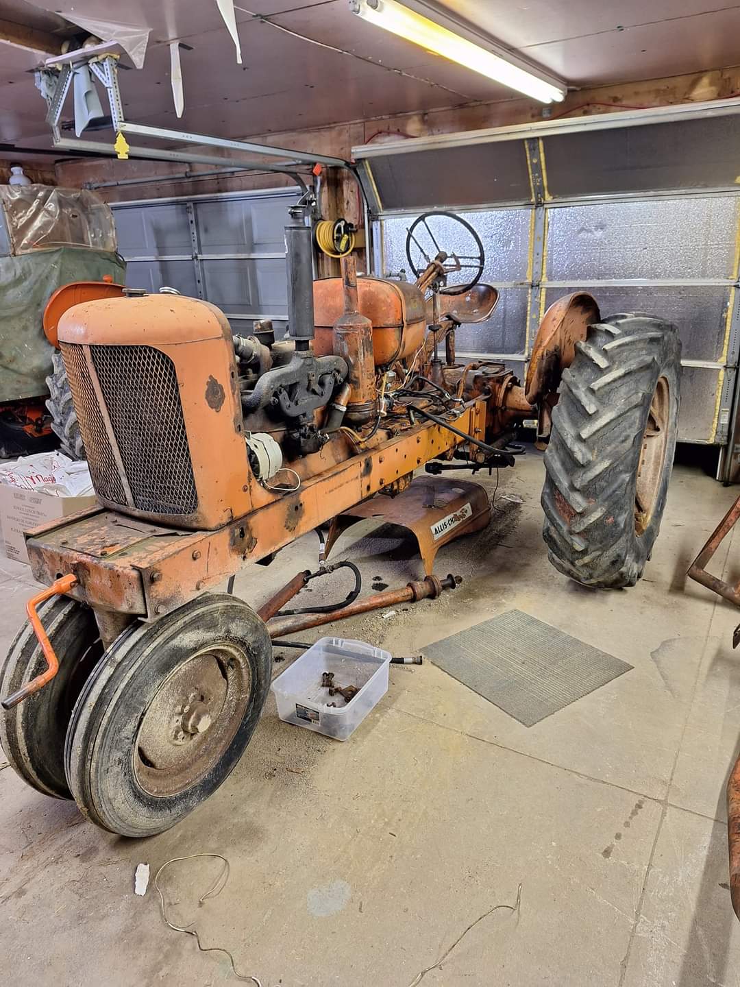

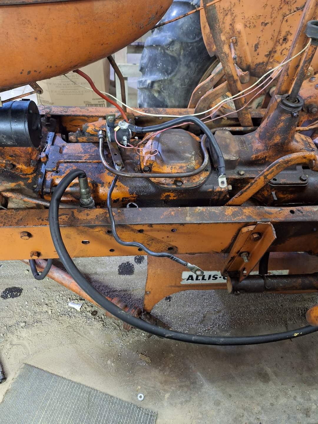

Well, I got the loader frame off tonight and set it aside. It will go on the WD45 in the spring. I began my first visual assesment of the tractor to get an idea of what needs done. The list of what I found on my first once over is included in the photos. Tomorrow or this weekend I will see about what is locking up the transmission. I did notice the block has been repaired at some point. It seems to be holding but I think I will have it ground out and a more thoroughrepair made.
Till next time!

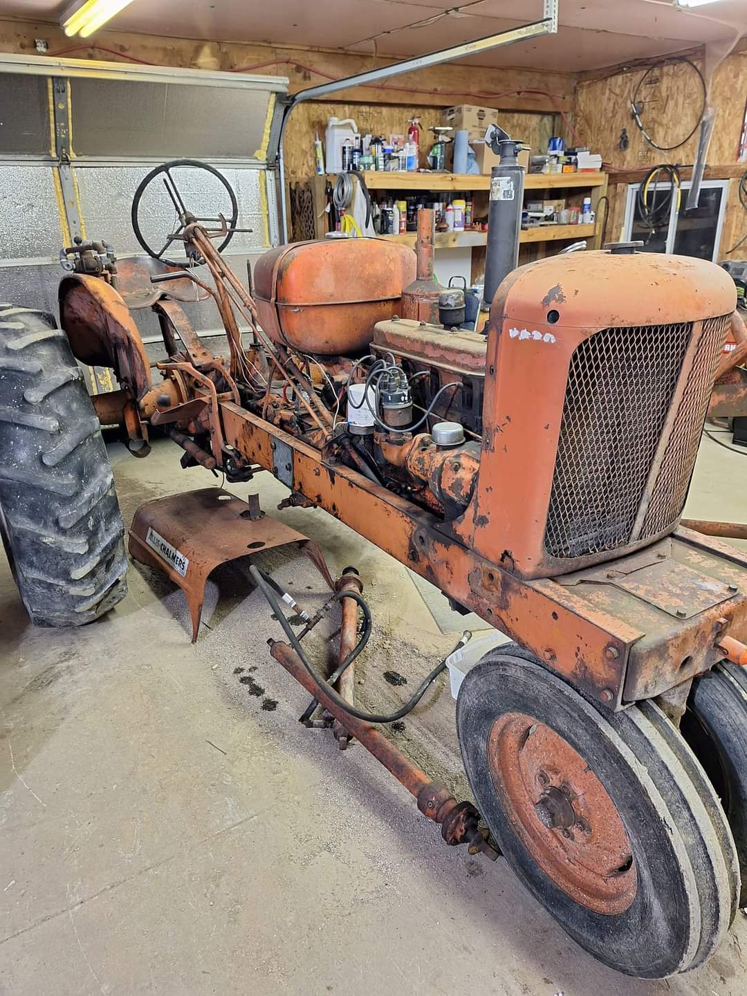

Got to be the best smelling shop in town !!  Big smile
really... that is a good looking Straight Tractor !

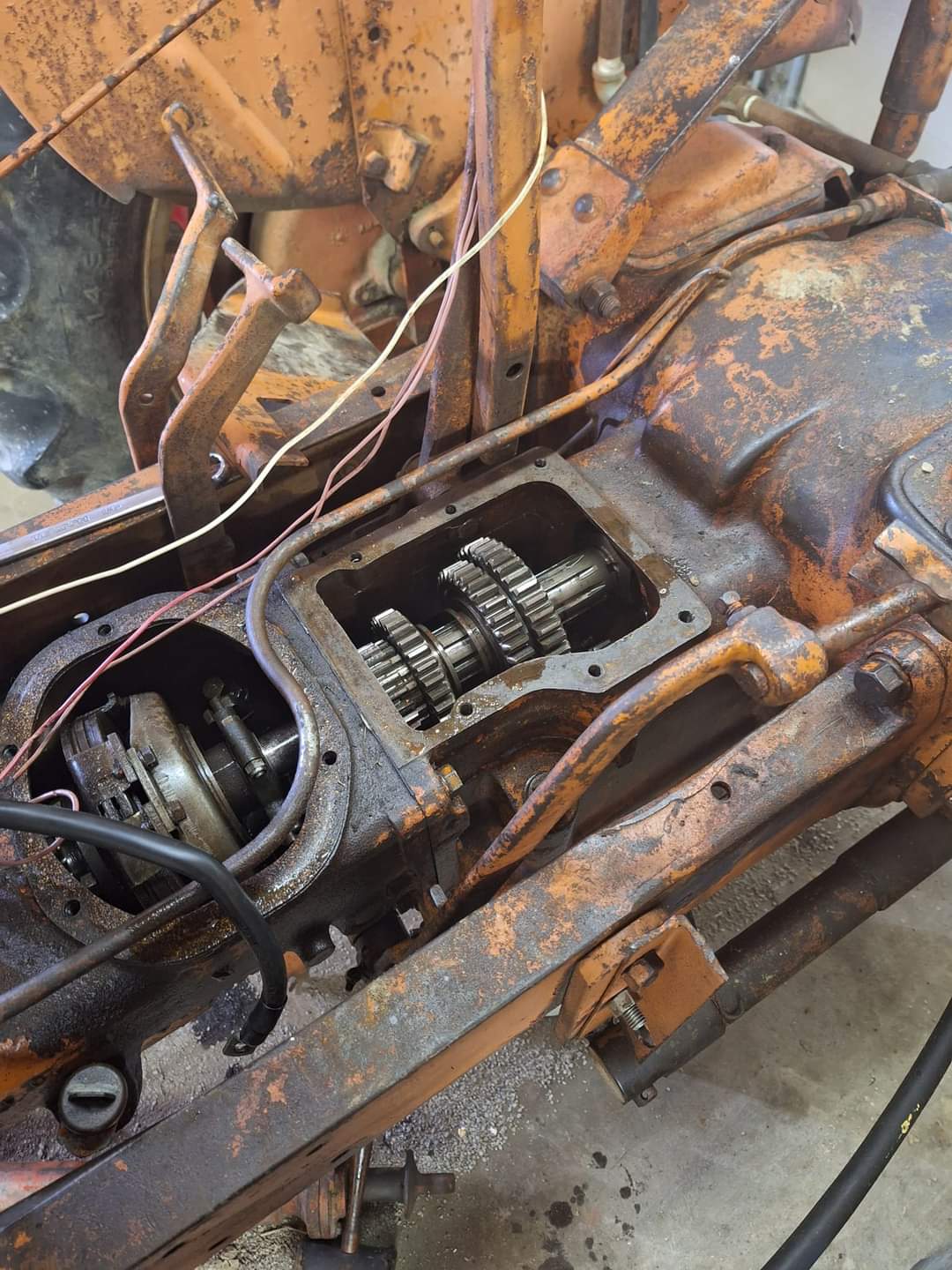

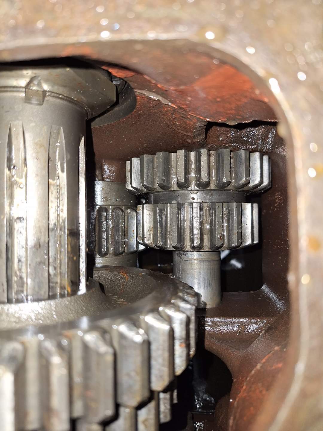

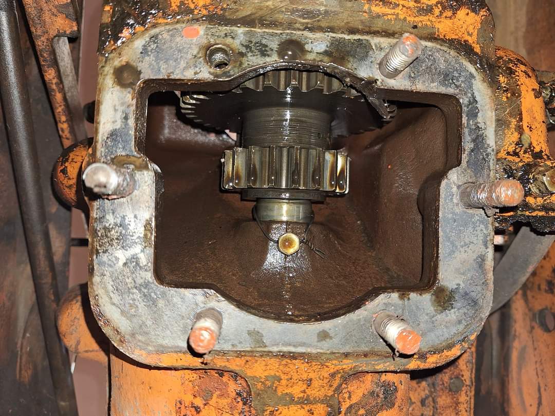

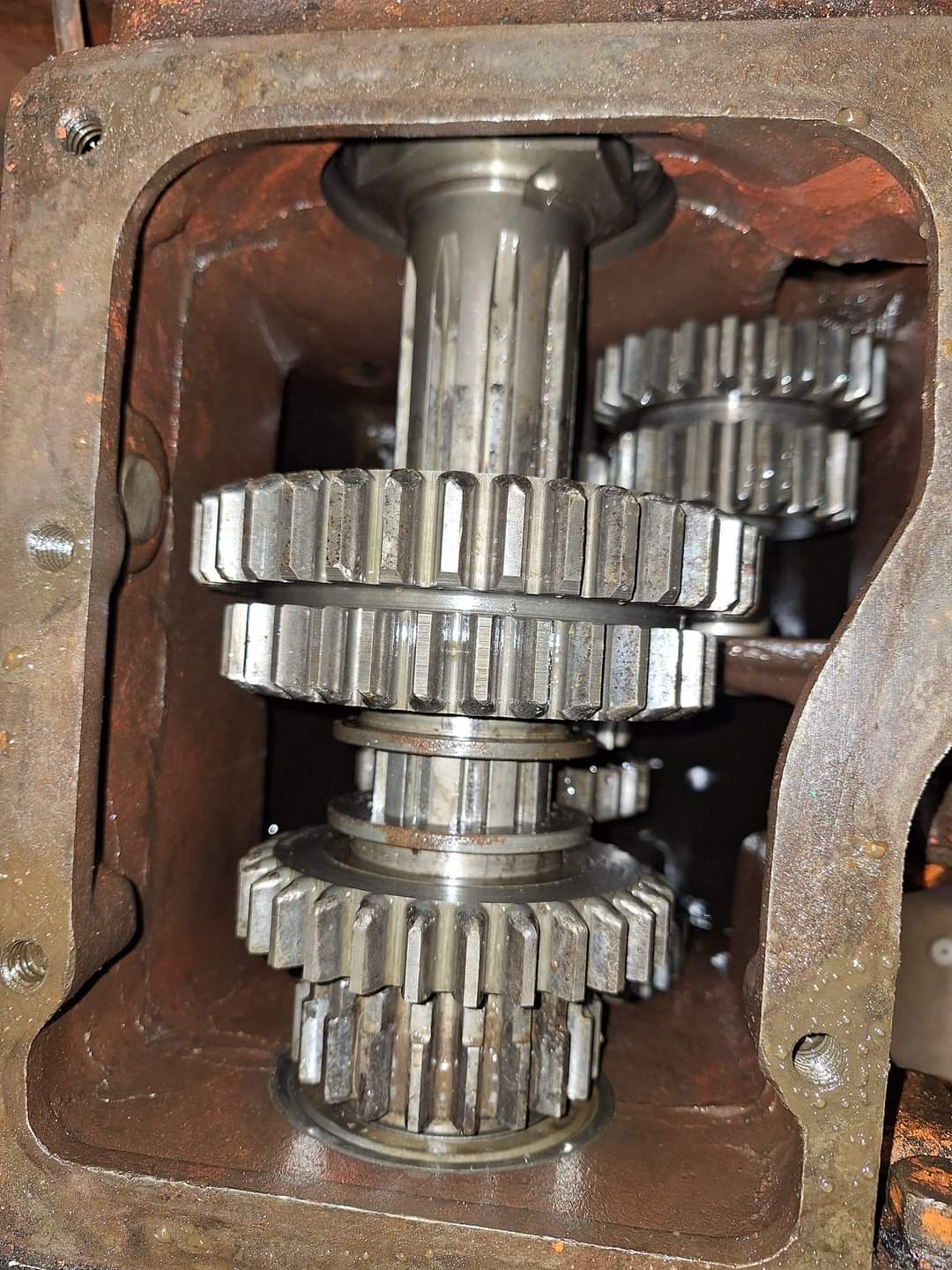

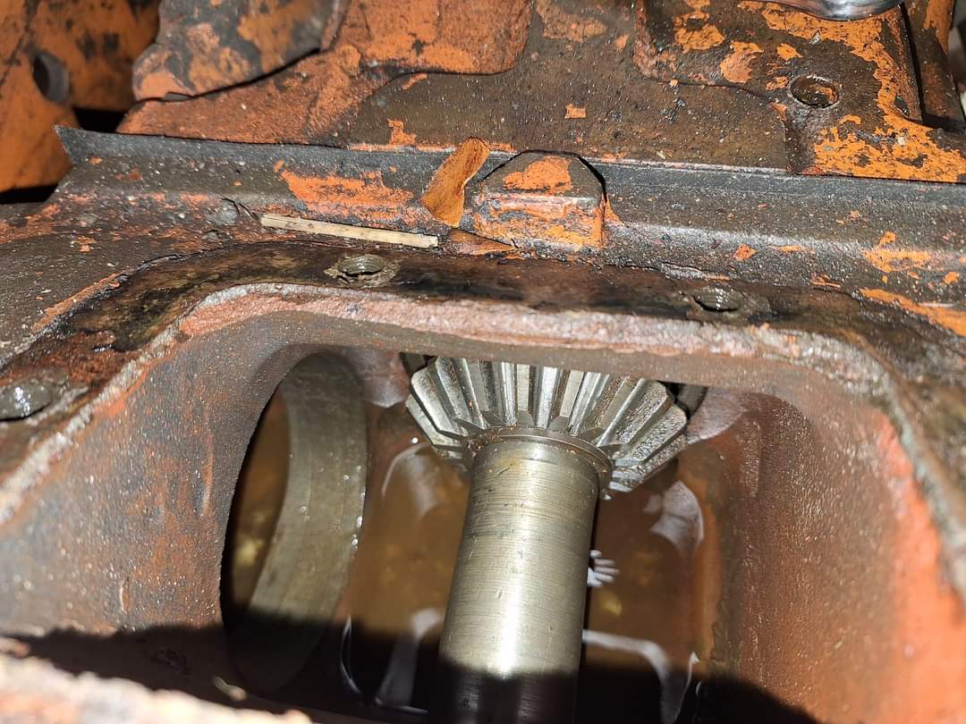

Well, I pulled the PTO gear box off, found nothing. Everything appears to be in good shape, hand clutch seems to be functioning. Checked main clutch, appears intact and functioning. Went ahead and pulled the shift tower, noticing it wouldn't shift to third. Well, thay issue was immediately diagnosed as a bad shift fork slide. I'll clean up the rust and see how it functions after, but I may just replace with a good used shift tower.
From there, I was able to inspect the transmission. Everything looks to be in fairly good shape for a 72 year old tractor. That said, it still seems to be locked up between the transmission and the main clutch. The tractor will roll fine in neutral. It will turn over and even start with the clutch pushed in, but as soon as I let off the clutch both in Neutral and in gear, it bogs out and stalls. I'm thinking the next step is going to be splitting the tractor to get the pto/hydraulic/hand clutch chunk out and get a better look, unless one of the experts have a better suggestion G_1704404825226.jpg[/IMG]

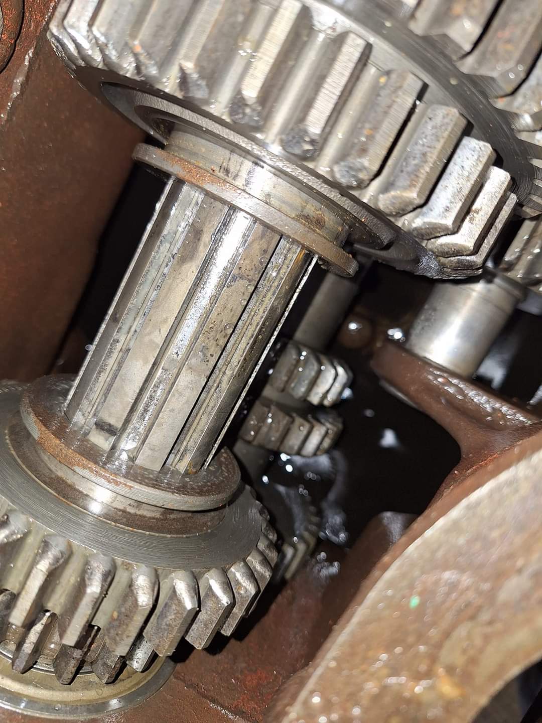

In the picture of the pto gears, it looks like a gear tooth or something is wedged between the  pto gear and housing,  and the housing is cracked.
AC WD45 View Drop Down
I believe you are referring to a picture of the transmission case where there is a visible casting flaw. Otherwise I do not see where you are seeing a cracked housing. I believe DR Allis is 100% correct. I thought he was referring to the photo of the engine clutch at first. What ever the issue is it is in the PTO drive set. I've gotna few ideas to try now when I get back to working on it. On the bright side, the final drive for the PTO is in excellent shape.

Post Options Post Options   Thanks (0) Thanks(0)   Quote Ted J Quote  Post ReplyReply Direct Link To This Post Posted: 04 Jan 2024 at 11:26pm
Is this what you mean Dave?  In the lower right hand corner?  Looks like it's cracked to me also and you can see a piece sticking out.
[/IMG]
I see what you are seeing. That's what I thought iy was too, but it's nasty RTV silicone from who ever had it apart last.

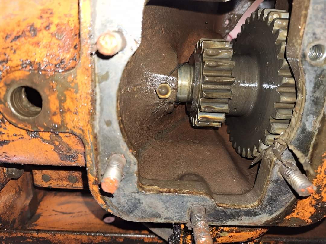

Get a bar against the hand clutch O.D. (foot clutch locked/released) and turn the top towards the RIGHT (clockwise) sitting in the seat. Maybe a large punch and 4 lb hammer. Something is wedged.

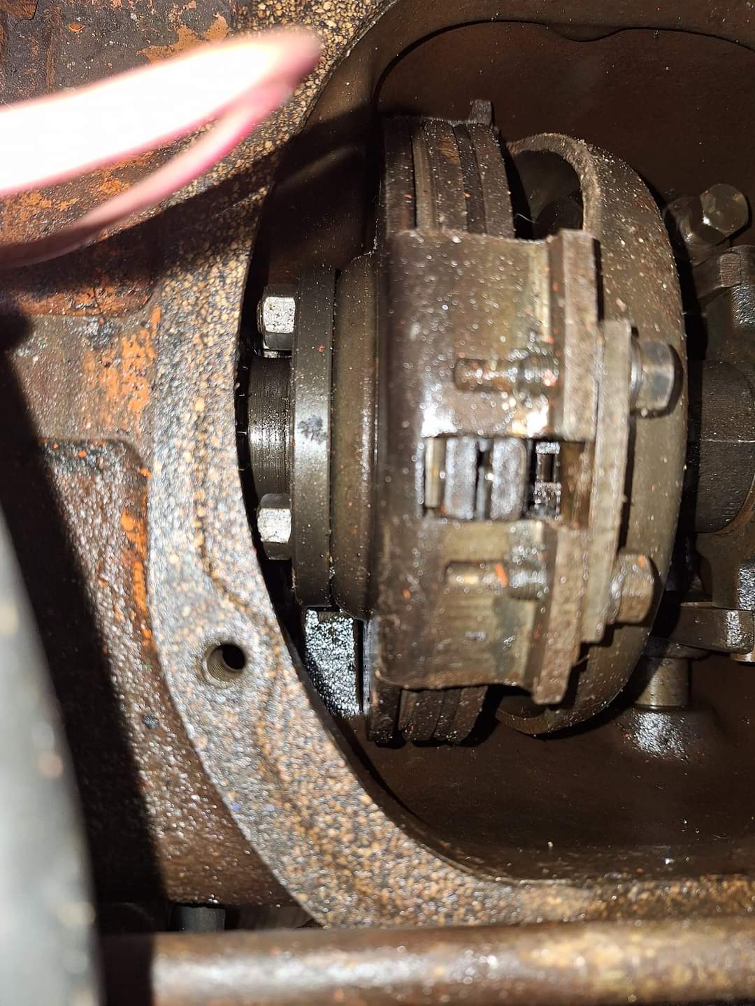

Dr Allis, I took your advice and tried moving the hand clutch. The hub bolts forward the clutch are hitting the pto drive gear. Underneath it almost appears the gear set may have slid backwards?
German Shepherd dad
1957 Allis Chalmers WD45
#WD234847
1951 Allis Chalmers WD
#WD88193
Points: 22799
Post Options Post Options   Thanks (0) Thanks(0)   Quote DrAllis Quote  Post ReplyReply Direct Link To This Post Posted: 05 Jan 2024 at 4:48pm
There's your problem. Looks like a split maybe ??? Not there to see.
No split, I'm thinking that retainer bolt wore and allowed that geat set to back out. Snapped the darn bolt trying to back it out, going to try and extract it tomorrow.
