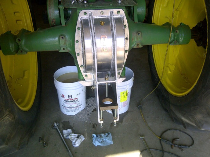

A few pictures of my puller
Charlie

looks good. Updated oiling system, and I like the hitch, simple and light. I had something similar in mind for my puller build.

I'd like to get a shorter height control adjuster, I know I am below the axle but if the hitch broke I think it would still be way to high

Post Options Post Options   Thanks (0) Thanks(0)   Quote Gary in da UP Quote  Post ReplyReply Direct Link To This Post Posted: 30 Sep 2015 at 6:09pm
Why would you punish yourself with that seat ?

Post Options Post Options   Thanks (0) Thanks(0)   Quote Charlie175 Quote  Post ReplyReply Direct Link To This Post Posted: 30 Sep 2015 at 6:37pm
No issues. Just riding it down the track
