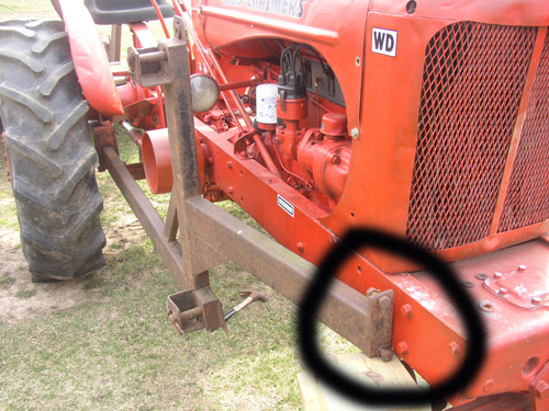

Greetings gang,
I just picked up a Kelly trip loader for my Allis WD. How do I mount it to the front of the tractor? Did Allis make a universal bracket for connecting loaders to the frame, or is it something I am going to have to make with some angle iron? I am a visual sort of guy, so if you have a picture that would be great. Also what do you think is the load capacity of this unit?
Thanks in advance,
Jake

Why don't you post a couple of pics of what came with the loader so we know what you have, first. it would be easier for someone to tell you what you need, lf they know what yo have

Here is a pic of what I am trying to do. It is a Kelly Loader. I am visioning some angle iron, unless Allis made a special bracket that will make this work.

Welcome to the forum! Not the foremost authority on the loaders, just wanted to say hi. I think you may be on the right track with the angle iron. Others will know for sure.

Yep, a heavy piece of angle will do the job for you. Also, I suspect that there was a cross cbrace at the bottom of the towers that I cannot see in the pic
