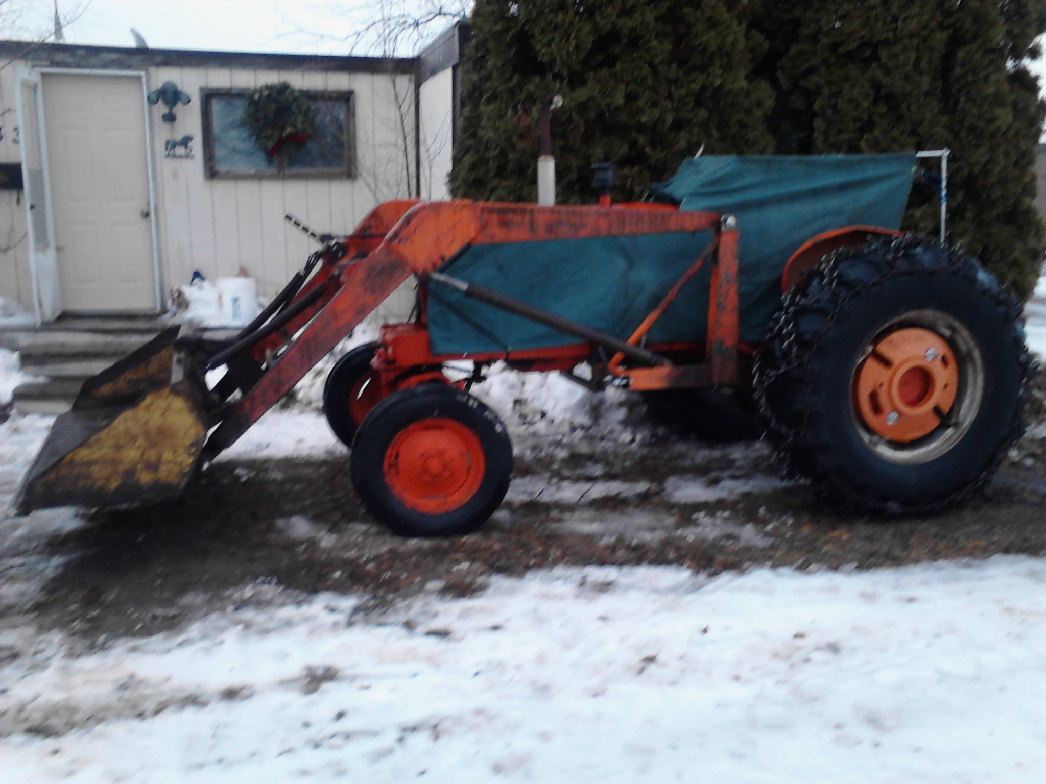

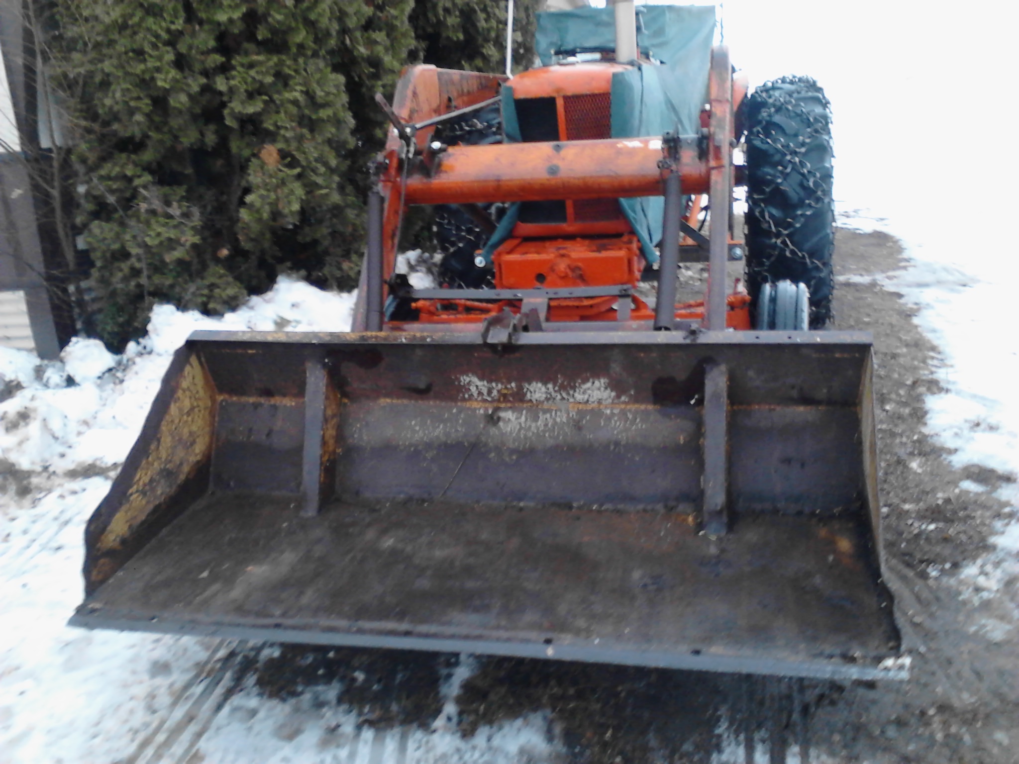

Post Options Post Options   Thanks (0) Thanks(0)   Quote truckerfarmer Quote  Post ReplyReply Direct Link To This Post Posted: 21 Nov 2017 at 7:00am
Couple pics of tractor and loader. Loader is a New Idea 50?. Tag is messed up so I can't read the last number.

Actually sae 30 is thick for winter. The WD manual suggests changing to 10 or 20 in the winter depending on temperature.

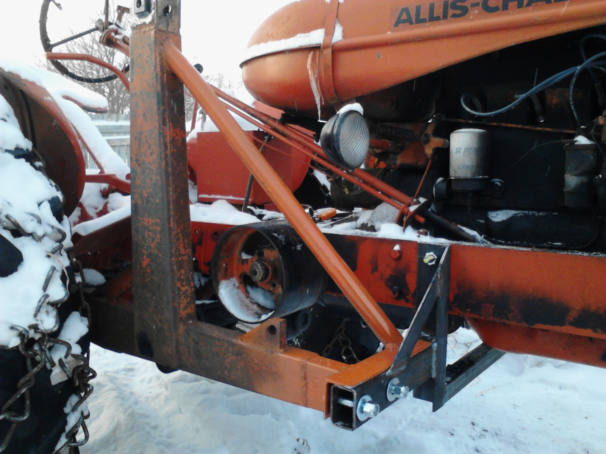

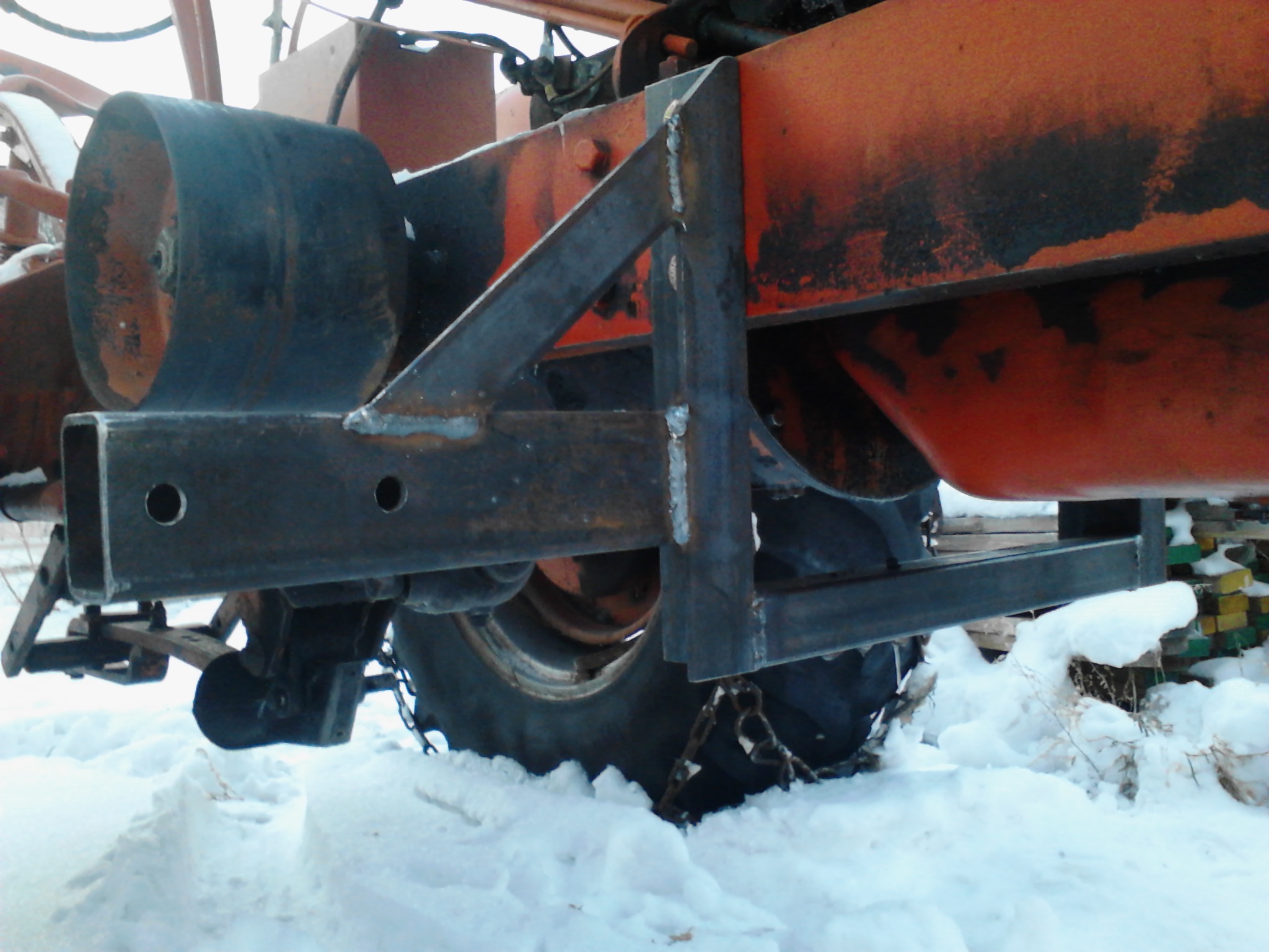

Anybody have any idea what model my loader is. That is not the correct bucket. Also the front of the mount is not original either. It is supposed to have 2 pieces of flat iron hanging down from the frame that a large shaft goes through. The shaft was rusted tight in the tube that it slides through and the ends were bent. I fabricated my own mounts for it.
Edited by truckerfarmer - 22 Nov 2017 at 6:15am

Post Options Post Options   Thanks (0) Thanks(0)   Quote truckerfarmer Quote  Post ReplyReply Direct Link To This Post Posted: 22 Nov 2017 at 6:20am
Here you can see what I did to repair the front mounts.
