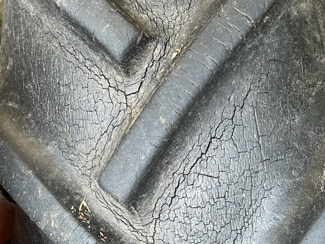

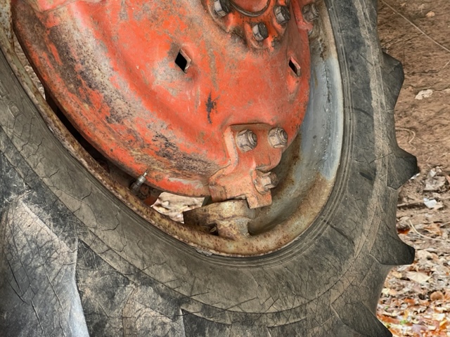

My second question is on advice of how to go about replacing tires on this tractor which is located in a relatively back-woods remote location.  These look pretty cracked to me (see photos) but I'm not sure just how evil-looking they get before failure--they're still working fine at the moment.  I don't have a trailer to haul the whole tractor into town.  Do you take the wheels off using the 8 central lugs, or the rims and tire off the wheel at the 4 clamps, or do you suggest calling some tractor-tire repair service (assuming one exists) to come out and do it on site?  I suspect these are deeply rusted into place, so suggestions would be welcome.  I have relatively few tools available out in the woods other than  jack, big wrenches, propane torch.

I'm running some look way worse than that. Wouldn't scare me to air em up and roll it to a better location for service work

Thanks for the note:  the tires are working fine at the moment and the Allis is parked in an open shed at my hunting shack--it's just that this place is WAY out in the sticks (and under 3' of snow in Wisconsin at the moment while I'm enjoying spring in NC).   Other posts seem to suggest that getting old wheels off can be quite a challenge--so I'm looking for advice as to both if these are in such bad shape that they need to be replaced, and tips on how best to manage that (I haven't checked whether they are filled with CaCl yet either--trying to avoid getting squashed like a bug).

the spin out clamps are what they talk about being a PAIN.... Take that photo to your local tire guy and ask him if you take off the 8 center bolts and bring the tire and wheel into his shop, if he will change the tire leaving the wheel attached... Im not saying you need it done right now.... but the easy way is to remove the 8 bolts, throw the tire and wheel in the pickup, and take to the Tire Shop..... normally some kind of Farm Service Center or  Tractor Dealer can do that, and supply the tires.... check out the location  / cost / leaving rims attached before you jump in.

If you are good with a big hammer, Remove the eight bolts that hold the eccentrics. Hit the wheel center on the outer edge, not the rim. The rim and tire will come off along with the four eccentrics.

Jack up the tractor. Since your removing the wheel for tire replacement I like making sure the eccentrics come loose and are functional first. Great time to check them. I always spray the eccentrics with some Kroil first. If you have some time, let the Kroil soak in for a half hour. Use a long bar on a socket to loosen them. I have a Milwaukee 1/2” impact gun that will spin them loose quickly. Watch the tab as they only spin 3/4 of a turn. Remove the stops on the rails also. Once they are working well tighten them back up. Then you can remove the clamps from the wheels. If time permits it’s a great time to clean up the rims after the tires are removed, bring them home and repair any damage and paint them. Much easier to do with no tires on.

well I'm relieved to know everyone isn't horrified that I'm driving around on these old tires at risk of sudden death and dismemberment.  Given it's limited use and that fact that tires seem to cost as much as the tractor, i've been dragging my feet on replacing them (maybe I'm not the only foot-dragger in the AC community?).  I'm pretty sure the Allis is going to outlive me, but I'm probably not going to get another 10 years out of these tires so perhaps replace sooner rather than later?
It looks like folks use both removal strategies: removing the 8 eccentric bolts or removing the 8 central wheel bolts.  Perhaps the decision depends on which I can actually get loose.  It seems I've read struggles with both strategies: The eccentric bolts seem to be particularly hard to remove without heroic struggles (and involve some weirdness on their threading?).  And the even with central wheel bolts loose getting the wheel off the axle seems to involve hitting things with really big hammers or using piston jacks (that I don't have) to lever things off?

If your not going to have the need to spin the wheels in or out and time is limited then just Jack it up and remove the lug nuts and remove the entire assembly. Our local tire dealer removes and installs new tires with the center still attached to the spin out wheel. He has our CA rims now to replace the dry rotted tires that are way worse condition than yours. Only reason we are replacing them is the sidewalls keep pinching a hole in the tube. Otherwise they have plenty of tread on them.

Re tires, AC720man: well, they're not going flat yet (and I'm unlikely to put much wear on them at 8 hrs/year) so maybe I'll keep my fingers crossed for a bit longer--thanks for notes.

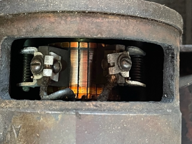

I do also have a photo of the brushes:

Any chance the rear tires are matched and Firestones? If so I would guess they may be the originals.They will give service a long time if lightly used such as mowing. JMHO.

Jack.. i think what Steve is saying is you have a 90% chance that the problem is INTERNAL...you already checked the wires / battery / ground... same as the last guy found... It would be impossible to say if a wire came loose, a brush has bad contact, a brush is excessive worn, a brush spring broke, etc... It could be about ANYTHING inside related to the brushes... Only way to find out is to open it up and look. ..... its 60 years old... time for inspection.

Jack, new tires are on our CA. Just removed the entire wheel assembly and dropped it off at the tire shop.

New wood,. If you remove those tires from the tractor, be very careful. If they are full of fluid they are going to be very heavy. I owned a farm tire shop for 22 years. I can assure you the easiest way to replace tires on a farm tractor is doing it with the rims on the tractor. It's far easier than you removing the rims and tires and taking them to a tire shop.

For what it is worth.... I have a WD-45 with tires in the same condition. They have been that way, cracked, for more than a couple of years and I have no intention of changing them. It is only used for very light work ... a wagon for hay rack rides and an Oxnard blade that I play with on my one acre yard with an occasional use of a Bush Hog mower that I had when on the farm as a kid.    SO   my opinion is do not worry at this point ... and as has been mentioned there are trucks that can come and do the tire work for you if you 'pay the piper'.

200tom1 and floyd: yeah, having someone come out and change them while still on the tractor was part of my original question--I have been searching for a place that does that in one of the towns around (between Merrill and Rib Lake Wisconsin) but I wasn't finding anything and as I said, this is a ways off the beaten track (and I don't have a trailer to move the tractor to a tire place).  But I'm encouraged that others are still running on similar cracked rubber, so hope springs eternal that I can continue to whistle past the tire graveyard.  But I may be whistling another tune soon enough if I get a flat, so I appreciate the inputs.

Les
The bit from the manual about "the generator terminals must be grounded if the 3rd brush generator is disconnected from the battery" takes some interpretation.  I imagine this also relates to a warning about running the tractor without a battery (which you could do using the crank to start) or if you disconnected the battery while it was running.  But it seems like a puzzling recommendation doesn't it?  Removing the connection between the field terminal and ground (which is how the tractors were shipped from the factory) would seem to do the trick:  you can't set up a field current if that terminal isn't connected, so the generator can't generate anything without it.  I seem to recall from some other thread someone suggesting just such a disconnect as a temporary solution to overcharging (e.g. if resistor has burned out, you could use a simple toggle to either allow or not allow the field terminal access to ground).  Am I missing something here?  Running the tractor and generator with the field terminal disconnected would seem to put the generator at no risk.
The fully charged battery/high resistance leading to even higher field and higher voltage has got to have some other limits (otherwise all these generators would be increasing voltage/current in an out of control feedback loop).  Perhaps part of the rationale for developing actual voltage regulators, followed by subsequently dumping the whole generator for alternators.
Who knew I'd be learning so much electrical theory to mow some roads?!
Les Kerf View Drop Down
Joined: 08 May 2020
Location: Idaho
Points: 1633
Post Options Post Options   Thanks (0) Thanks(0)   Quote Les Kerf Quote  Post ReplyReply Direct Link To This Post Posted: 12 Apr 2023 at 11:19am
I'm still not quite ready to deliberately ground the armature of this generator Confused
The word "terminals" is plural; there are only two terminals, and if the field terminal is grounded the generator will attempt to produce maximum current, which would then put this amount of current directly to ground. I do not like this idea. Shocked
I agree.
There will be some current generated due to the residual magnetism in the field coils, perhaps this small amount of current should be grounded?
Yup, you got it! This system was the lowest-cost solution at the time and was adequate for a tractor that would typically be started in the morning, ran until noon dinner, then re-started and ran until evening chore time.
I suspect that the field coils in your tractor are partially shorted out internally, resulting in higher field current than normal. This is why I keep going back to measuring your actual field current.
The WD/WD45 shop manual specifies 3.5-4.5 amps of field current @ 6 Volts, with an output of 10-13 amps @ 7.4-7.7 Volts Hot.
You could reduce the field current by installing an ignition ballast resistor in the field circuit, but best practice would be to replace the field coils if they are bad.
I too have learned something; I have been an electronics tech since the 1970's and have a pretty good grasp on this stuff, but I had never before delved into the peculiarities of the Third Brush generators. This has been fun Smile
