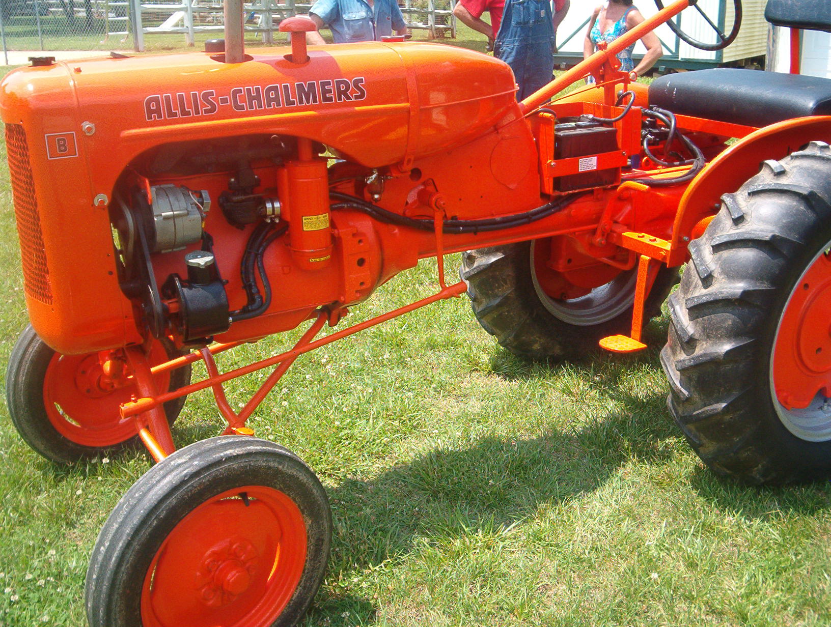

This guy added an aftermarket pump to run off the front pulley.
