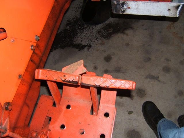

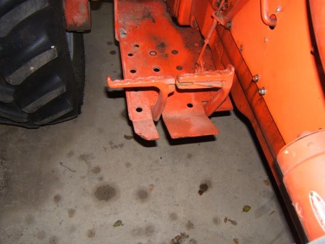

If this works, here is a couple pictures of my D-10 series III brake peddles tie.
Sorry didn't work.
Dusty
Edited by Dusty MI - 05 Oct 2018 at 10:53am
Points: 18967
Post Options Post Options   Thanks (0) Thanks(0)   Quote Ted J Quote  Post ReplyReply Direct Link To This Post Posted: 07 Oct 2018 at 6:15pm
I hope this works Dusty!!
As you said, they look like they are Allis castings of the pedals.
AND, they are EXACTLY like the ones we had on our CA back in the 60s.
There ya go guys!!  Anybody got extra thick brake pedals out there?

I wonder if they are aftermarket? Would be nice to find a set sitting around somewhere.

Per the parts book, the D10 and D12 DID have interlocking pedals.  Those pictures are factory.  I would imagine with some work, they could be adapted to a WD.

D15 S2 and the 170 both have the same interlock on the brake pedals.  Show up in the parts book, so would be factory.
