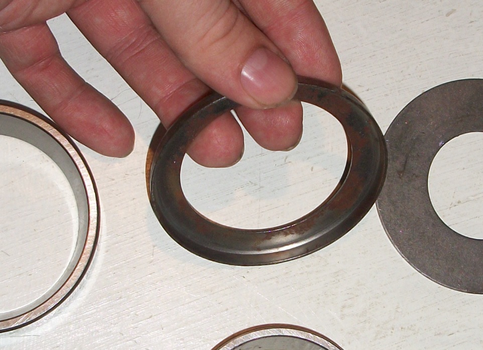

Also, sidebar, in my new bearing parts kits, I see one item that doesn't look like anything I pulled out... There's a curved piece that looks like part washer part cap. Does it go with the inner bearing somehow?

The cupped ring is the outside retainer for the large felt seal. the large washer covers the inside of the seal.

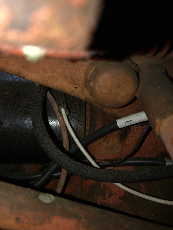

So my starter snugs up in this position. Just seems like its out farther than normal??

It's coming along nicely, Chris. I'll take a look at the starter on my 45 and see if it sits proud like yours.

Starter is out too far.

The starter is in place where the divot is in the starter housing. Now I am not sure this is a correct Allis starter? Was on the tractor when I got it and the starter did function OK. Not sure there is any way to verify bendix to ring gear engagement? As in a visual. Might just have to measure from know point to the ring gear and then check starter bendix outward dimension??
I will add that to the list. I dont want to ruin a new ring gear.
Worked on front wheel hub assembly:
Washer and spacer in place:
 This cupped washer hanging on the spindle is not in correct position. I was trying to figure out which way it went. Well it goes into the hub the other direction. I covers the big bearing and provides a face for the felt seal to set against. I oiled the felt seals.
Cupped washer in place: I believe this is the correct position/ direction?
Outside bearing, washer and thick washer, nut and cotter pin:
Need wheels!

Chris, here's a photo of the starter in place on my WD45. There's almost no separation between the starter case and the housing. What this means for your starter I do not know!
Dave

Interesting, mine sits a lot like Chris'. It was that way when I bought it, and when I had it rebuilt a few years ago, it fit back in exactly the same way.
And Dave, I don't know if there's room on here for TWO shameless's, so yeah, I am ashamed lol!

I checked the starter dimensions and when the bendix is not driving the ring gear, back in home position) it has 1/4 ish clearance. So it is good in current location. I have also seen some older starters fit right up tight to the bell housing. Not this one. Had that starter in and out 4 time I think. Good suggestion from Don(MO) was to clean up the mating surface, and apply some dielectric grease. Should have real good ground!
