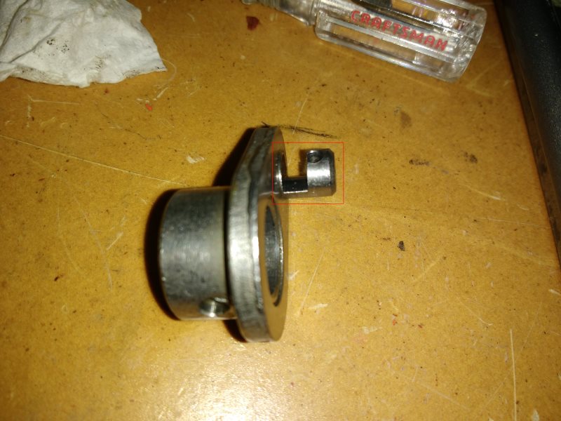

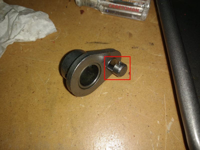

I'm having trouble with the hydraulic lift on my WD45. I rebuilt the pump 2 years ago, and things seemed to be okay for awhile, but a month or two ago it just stopped working. Readjusting the linkage per the manual didn't fix anything. Even when it was running, it still didn't seem great.
That brought to mind something I noticed when I rebuilt the pump. One of the pieces of the control linkage had what I though was some interesting machining done to it. But as I thought about it, I realized that could be the source of my troubles. I pulled the pump off and that part out.
If it's wear, it wore so nicely. But it seems like it would have been a strange way to design the part. So I thought I'd see if anyone could confirm that indeed the pin is worn, and it's not like it should be, before I repair it. It's the part referred to as the "Control Lever" in the parts diagram, circled in red in the image below. The suspected wear is squared in red in the next two photos. Thanks for looking!

Wear over time usually doesn't suddenly stop something from working. Generally things begin to get sluggish first. I smell something in the pump instead of something in the controls.

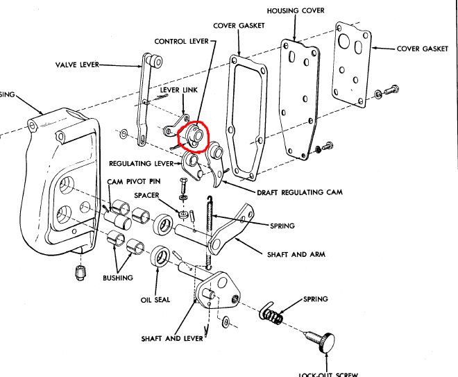

that's the regulating lever. I welded a new pin on mine. I had problems With my CA till it didn't work it whet up and wouldn't come down till I listened the Hyd line and let the fluid out. That pin was completely gone. I welded a new pin on and it worked better than it ever had. the pin cant be any longer than the original. I didn't know that the first time until I had assembled it.

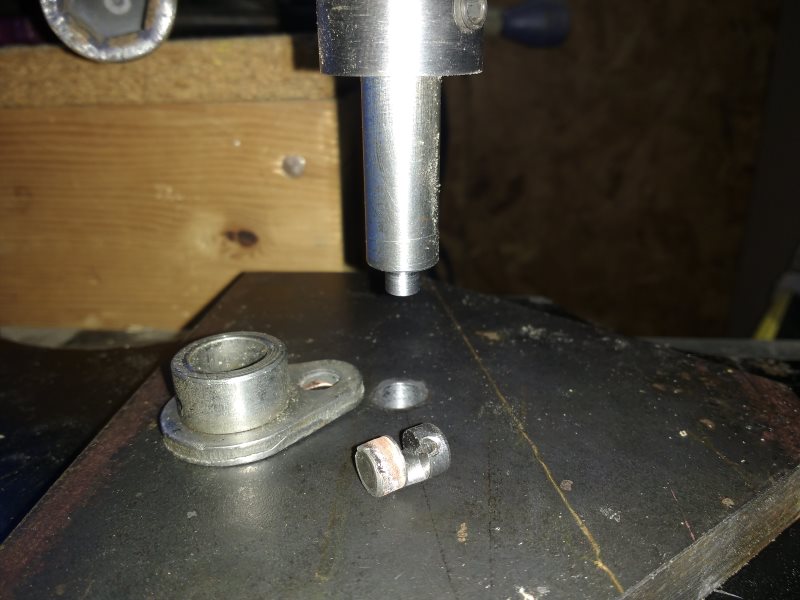

Looking at it, it seems like the pin was pressed in. My plan is to press is out with my press, and then press in a new one I'll make.

 I don't have the answer, but I do plan to take my pump apart in the near future I will check mine. I have had one of these apart. but it just doesn't look like wear.

I agree, it definitely doesn't look like wear. And yet, it seems like a strange way to machine a piece. It doesn't seem like it would be strong enough. However, I don't see any wear on the mating piece. Perhaps one is heat treated, the other not? Although, again, seems odd.

I sent an email to Sandy Lake Implement, asking them about this. This was their response:
"...that is quite typical for wear on that part. He also said  they would normally weld them up. You could also knock the pin out and replace it."
So I will continue on with my repairs. Hopefully this fixes my problem. And props to Sandy Lake Implement for a quick response!

I believe the draft regulating cam was changed to different profile in the WD45's.
garden_guy View Drop Down
Joined: 05 Jul 2013
Location: Illinois
Points: 1167
Post Options Post Options   Thanks (0) Thanks(0)   Quote garden_guy Quote  Post ReplyReply Direct Link To This Post Posted: 20 Nov 2018 at 8:03pm
Is this related to traction boost? Or am I getting concepts mixed up here?
Points: 8964
Post Options Post Options   Thanks (0) Thanks(0)   Quote SteveM C/IL Quote  Post ReplyReply Direct Link To This Post Posted: 20 Nov 2018 at 8:15pm
Yes it is. I don't remember the deal but it seems like it was to soften up the reaction of TB or something like that. The 45 had enough more snort that it wanted to move the hydraulics to much/quick. I could be all wet but i'm sure it got changed.

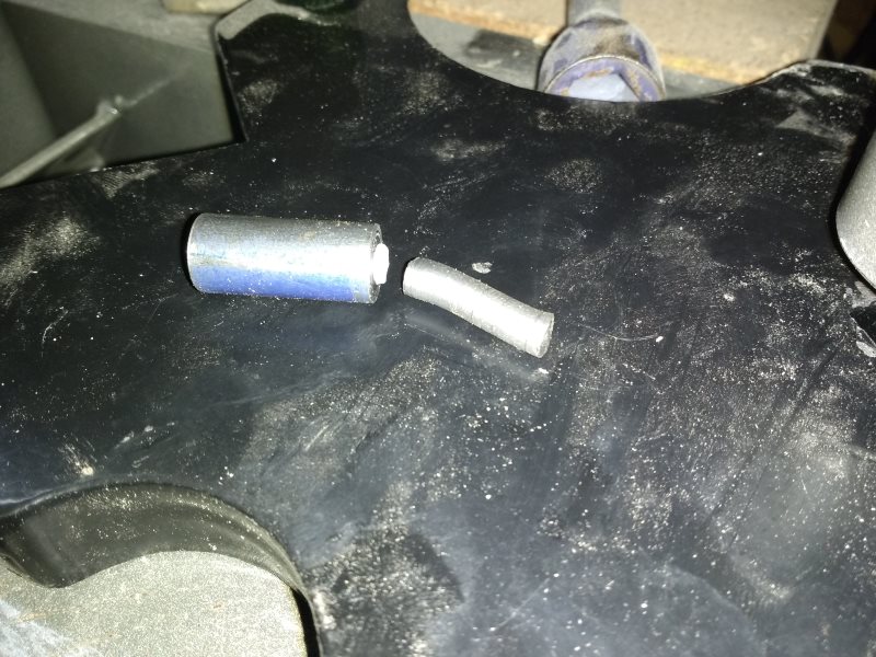

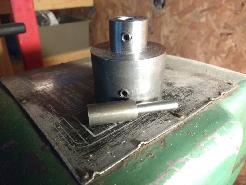

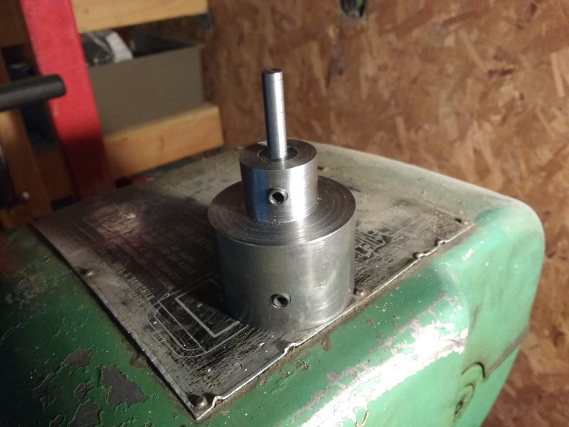

I made an adapter to hold a punch onto my shop press.
Those of you with experience with cheap hydraulic presses will probably guess what happened.
The piece that the hydraulic jack sits on shifted, causing the punch to get bent. While trying to straighten it, it broke.
So I made a new punch, that had a much shorter section that was narrow. And used some shims between the piece and the frame, so it couldn't shift. This worked much better.

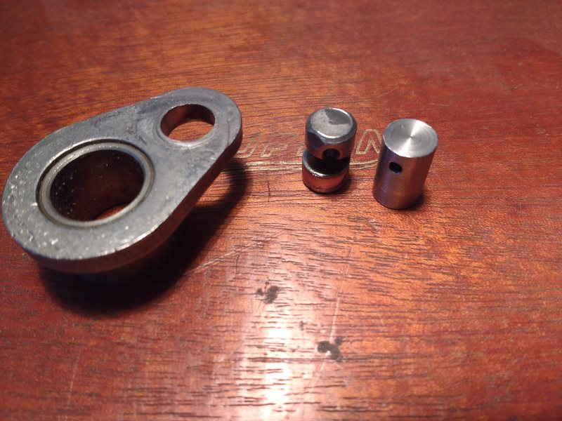

Some of the pin stayed in the hole, so I wonder if perhaps there was some sort of threadlocker in there? If I were to do it again, I would heat it up with a torch to break down any compound in there.

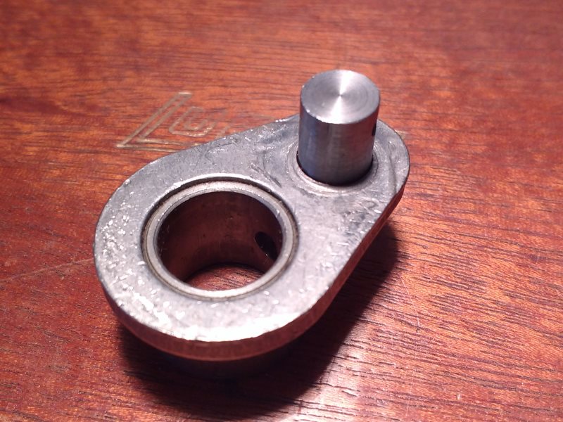

I turned a new pin, which had to be two slightly different diameters, one to fit the hole that it was pressed into, and a slightly smaller one to fit into the linkage that it attached to.
I pressed the new pin in along with a bit of threadlocker just to make sure.
The pump was reassembled, and along with rebuilt cylinders and new hoses, was put back on the tractor. After messing with trying to bleed the cylinders as specified in the manual and ending up with the packing sliding back out of the ram, I decided it was good enough. At first you could tell that at the end of it's travel it was compressing the air in there, but the air seems to have worked it's way out and doesn't appear to be a problem anymore.
With the repaired piece, I could actually adjust the linkages so that there was a definite spot where it raised, held, and lowered, unlike the 'ranges' that it used to have. The repair seems to have worked, and I'm happy with the result.

That looks like a good fix!!

Just ran across this. Wow, that is an impressive fix. Going to have to remember this.
Any chance the pin was actually threaded, given some stayed behind in the hole? Or just seemed to have something to hold it in place with a loose press fit?

I don't think it was threaded, I didn't see any signs of threads otherwise.
