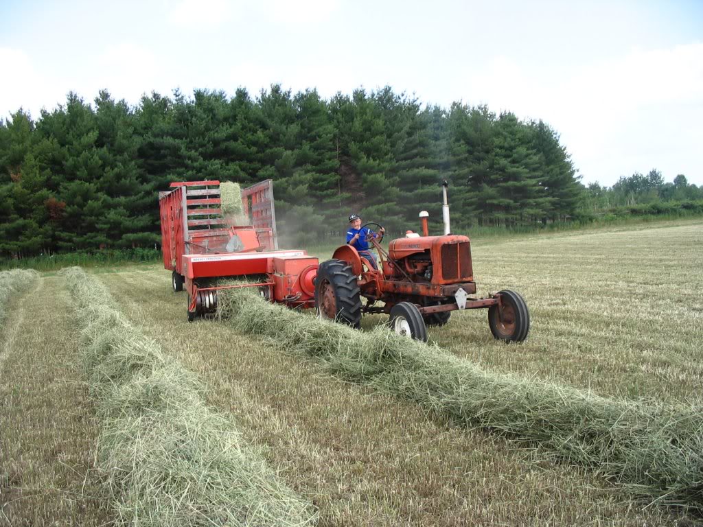

Post Options Post Options   Thanks (0) Thanks(0)   Quote Tony Elo Quote  Post ReplyReply Direct Link To This Post Posted: 24 Sep 2011 at 5:41pm
let the picture do the talking here

Post Options Post Options   Thanks (0) Thanks(0)   Quote DaveKamp Quote  Post ReplyReply Direct Link To This Post Posted: 24 Sep 2011 at 5:48pm
Great picture!

I hope that was photoshopped

One important thing to consider is if you look at Tony's photo the young fella rideing solo with his feet dangling down is right above the turning pto. With a rear entry tractor you have to be VERY carful how is running the equipment. ALWAYS turn off the pto befor dismount and hold on to be sure not to fall. The D series offer side entry and just that little bit of added safty.
